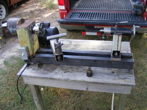

Very nice. I went through a phase of wanting to build lathes. I built a full sized lathe, a full sized treadle lathe, then a smaller benchtop sized treadle lathe. They are fun to make. Great job

Out of my league nice job. Do you use the chuck for holding everything that you turn or will it accept a MT2 dead center?

I did not fix the head shaft for MT2 center. I use an adapter that will fit in a 3/4 drilled hole in the wood blank and will tighten from inside the adapter and fit on the 1"8 threads on the head shaft you can see it in the photo in front of the lathe on the table .the tale stock has a MT2 for a live center
