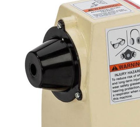

It just occurred to me that I vaguely recall that the plastic cap had a hole in it. I found this picture on the internet. While the bap between the handwheel and the metal shroud was significant, I suspect that it wasn't all that much different from the opening in the cap.
(Hate to admit it, but that cap may still be in the shavings under my lathe stand. It's been about ten years, and we don't want to go overboard with cleaning the shop - - -)
Ha. You should see my "shop" at the moment….
And you're right. I just checked mine - there is indeed a hole in the cover
