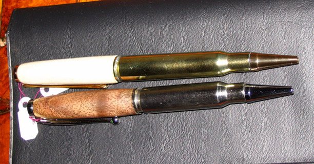

Here's a side by side of a 30/06 brass and a 308 nickel. You can do lots of stuff to dress these up. Pick guard material makes a neat center band---and you pointed out the rifle clips. I like useing antler also---really gives it the hunters appeal.
<br />

<b>Gary</b>, not trying to be critical, but did you sell the bottom pen in the picture? Things appear to be out of alignment.
