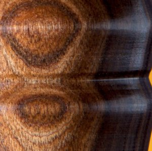

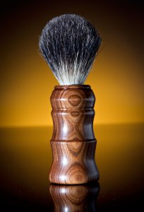

Here are two photos of the finished brush. It looks good at a casual glance, but close inspection reveals fine concentric scratches.
It was sanded with 6 grits through 600, both while turning and stopped, going with the grain.
Finish was 4 coats of Waterlox, light steel wool 0000 grade between coats. Dried overnight.
Need help to reduce the scratching. Have another to do, and would like to improve the quality.
fernhills
Jan 22, 2007
2,142
Hellertown, PA, USA.
Hi, i use c/a, but i try to keep the contour of the handle in shape of a genie bottle so the c/a won`t accumulate and cause issues with the c/a for me. I use personally, a Wenge wood handle for the last year with no finish at all, nothing happened. I occasionally wipe it down with baby oil, b/c that is what is in the bathroom vanity. Carl
