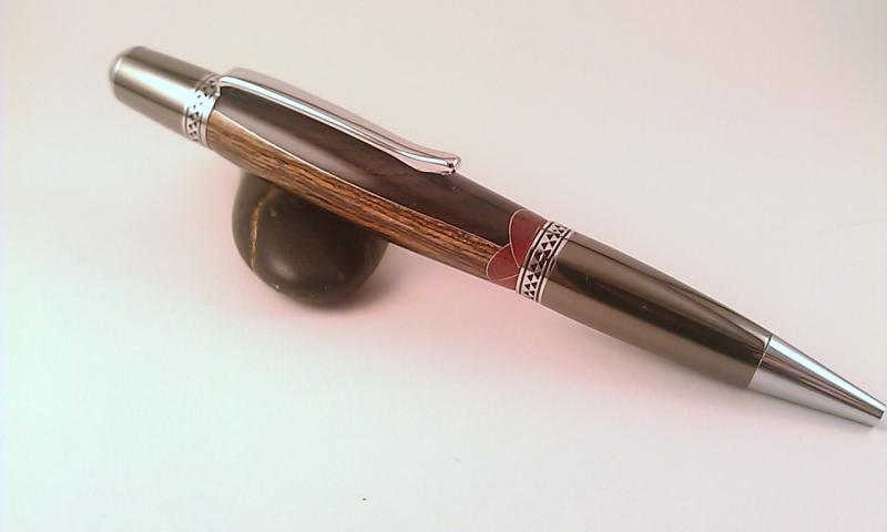

reiddog1
Oct 14, 2011
564
Jacksonville, FL
CA
All CA on this one. I use my sander to knock off the corners to almost round before turning. I also turn with cheap HF lathe tools. I just keep them sharp. A light touch and sharp tools seem to work for me. I rough up my soda can aluminum with 120 grit before I glue. Different strokes for different folks I guess.
Dave
