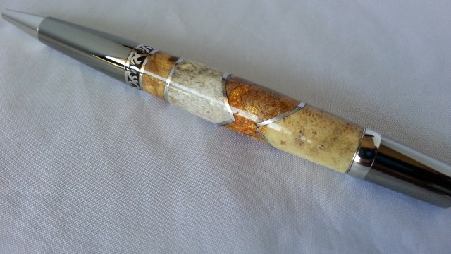

David had a great point in the thread he linked. These things will blow up because you didn't shave that morning, you had bologna for lunch or it's been to long since you called your mom...metaphorlically speaking of course. I just did a golden buckeye burl, deer antler and aluminum EB (wouldn't recommend that combo for yout first try!) and with 1/16" to go...the sucker let go on me. Good think I have a lot of Pearl-ex! They are a fun and worthwhile type of pen to work on...tough...but worth it!!
