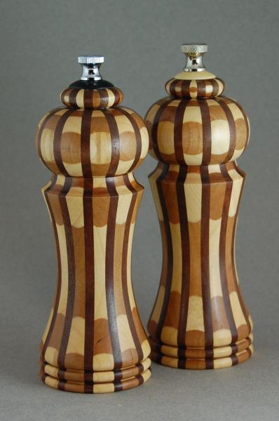

I'm looking for some guidance on segmented pepper mills like the one Jason Swanson posted here I know I've seen a tutorial but for the life of me can't find it maybe it was on another site.

Jason does sell his blanks, if you want them the easy way.
If you want to make them, you need a saw that is very accurate and will not "slip" once the setting is made.
There are 360 degrees in a circle, so if you wanted 4 pieces, you would cut them all 90 degrees. 12 segments, 30 degrees.
Do this enough times and then check your fit.
I saw him assemble one at an IAP meeting--made it look easy--personally, I would buy them---but you sure COULD make them---
Hope this helps
BTW, Jason does a week long class on how to do it, so expect a few failures.
