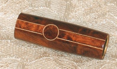

Jr. Gent, screwbean mesquite, amboyna burl center stripe & circle, maple veneer. The straight veneer is store bought. To get the maple around the circle, I turned a solid maple dowel to 23/64, and an amboyna dowel to 19/64. I then made a simple jig to hold the blank in the drill press, drilled a 23/64 hole and glued in the maple dowel. after that, I drilled a 19/64 hole and glued in the amboyna dowel. This was my first attempt, so it didn't come out as well as I'd hoped, the hole is kinda centered on one side and off center a little on the other, and the amboyna dowel is slightly off center.

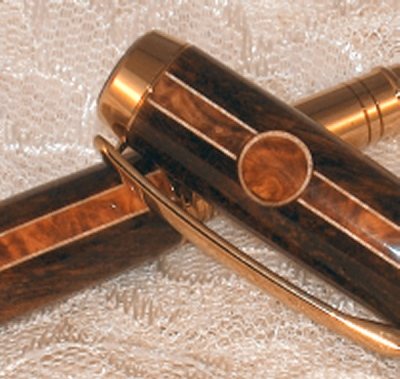

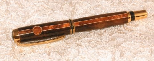

Figuring (correctly) that my problem was not starting out with a perfectly square blank, I tried again with desert ironwood, amboyna and maple. This one came out very well, but unfortunately, the lower barrel suffered from spontaneous rapid disassembly while turning. Not sure what to to with the survivor, thinking about pairing it with some elk antler I have, but I'd want to add some wood element to the antler to better connect it to the upper barrel. Maybe just a simple amboyna dowel?
As always criticisms & suggestions are most welcome.

Great concept and excellent implementation! I tried something like that, once. Even if it worked, it would not have come out as nice. I really struggled keeping everything centered. Even your "off-center" one looks pretty good, and all the pieces look great together.

Either the antler of the amboyna would look very nice with the survivor.

How about the bottom barrel just desert ironwood?

Thanks Ron. The only thing about using another piece of desert ironwood is that the grain won't match and it's possible the figuring & color won't match either, and I'd rather not have it look like a forced marriage. I still have one strip of amboyna I can use, though it won't be as thick as the upper barrel. That may be enough. If I make it too fancy, it'll detract from the upper barrel.

Correct me if I'm wrong, but that looks like a baron. Even with matching grain it will only match up 1 out of 8 times.
On the other hand if you where to use a different wood on the bottom I'd use something dark (ebony or blackwood) and not lighter (antler), JMO.
Either way, it's still a great looking segment

It's a Jr. Gent. I'll consider ebony & blackwood (I'm lucky to have some of each at the moment), but I'm still leaning toward the antler. Since the contrast between the desert ironwood and the amboyna is not large, I don't want to be too contrasty (if that's a word) with the lower barrel, might throw off the balance of the design. I might just end up polishing one edge of a bunch of different blanks and have a beauty contest to pick the best material[:D]
