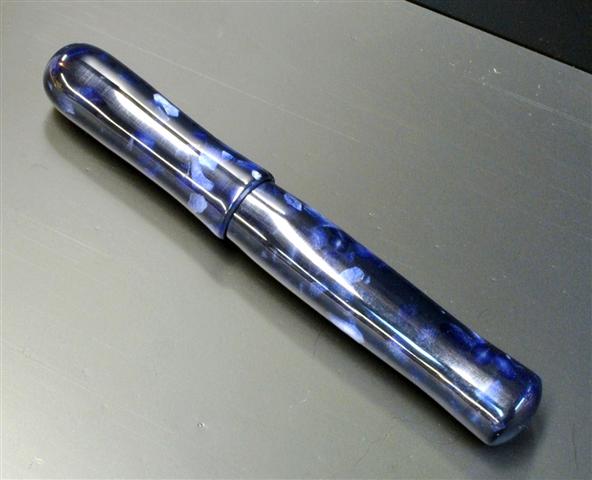

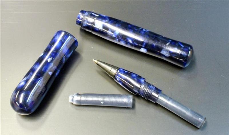

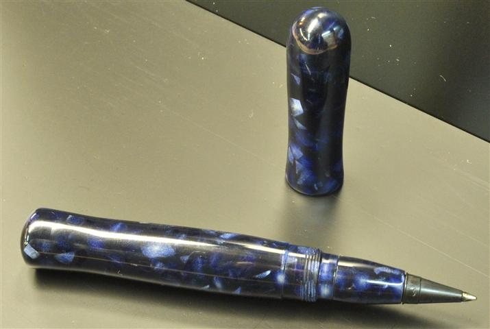

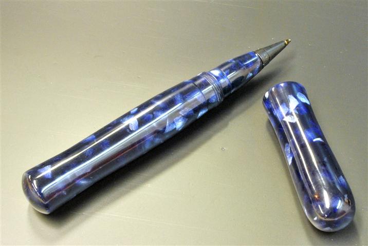

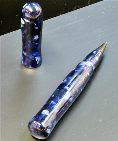

Just made a little roller ball with the little Schmidty. Writes nicely, too. This one is big enough to hold a spare cartridge. Sorry for the crumby pictures.
