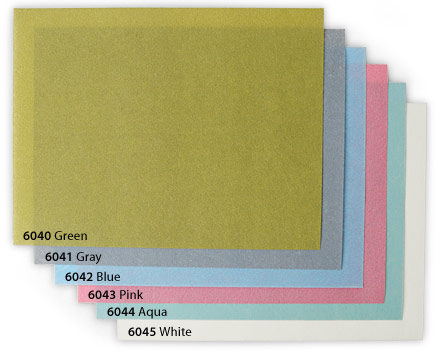

I've been using the sanding pads for plastic and wet-sanding acrylics. Is that the best way? Can I use regular sandpaper? The sanding pads seem to wear out so fast.
Appreciate all comments.

Sanding acrylics/plastics can be done with regular sandpaper. I often sand to 600 then change to micro mesh and sand wet. I also like the acrylic sanding pads sold by Arizona Silhouette. I have used wet or dry auto sanding paper. I suppose I have used a wide variety of sanding media and found them all quite satisfactory. I have recently started using a product from The Sanding Glove called 3M WetOrDry Polishing Paper. The package has 3 sheets each of 400, 600, 1200,3000, 6000, and 8000 grit equivalents and sells for $8.95.I really like the product and have no affiliation with The Sanding Glove nor 3M.
