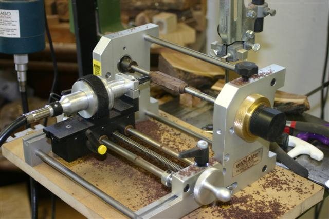

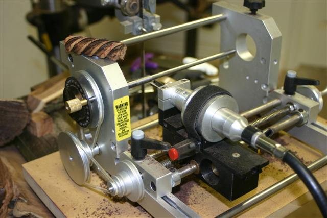

Geeezeee Don .... I had forgotten all about those photos in your article. Thanks for the reminder.
One other question (this is off track of the thread, but since I started it I'm certain I won't mind) ..... I saw an 8 sided pen in your album. Did you do that with a Legacy? .... a Router Crafter??? ..... by hand???
Just curious.
PenWorks
Aug 18, 2004
5,186
Scottsdale, AZ
Lets see if I can remember what it is called.....
mill lathe, the same defunk machine Rich uses.
I think Woodcraft use to sell this machine.
its_virgil
Jan 1, 2004
8,127
Wichita Falls, TX, USA.
Good Anthony! You got it right this time! Yes Al, it was done on a now discontinued stand alone tool called the MillLathe whick uses a
foredom tool for the cutting. Woodcraft was the only outlet as far as I know. It was sold as the basic unit and then separate kits had to be purchased. I happen to have all of the pieces except one. I also do spirals with it. I need to get it back out and do some spirals and give Anthony a lesson on spiral pens[:D]. Here is a picture of the basic unit. One of these pops up ever once in a while. Someone here was trying to sell a complete setup back last spring.
Do a good turn daily!
Don
