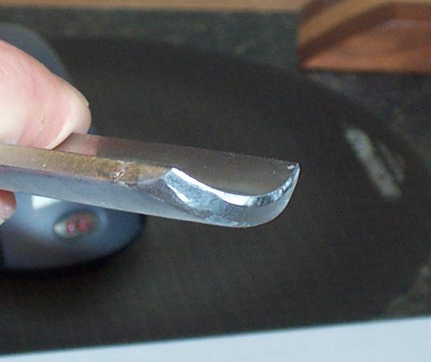

Some time ago, while shopping at Michael's I noticed these cancel of colored sand. The fine colored sand and bright colors I thought it would look really nice if I cast it in PR and turned it. So the other day I bought a bag and tried it. And sharpen my chisel and started to turn. It was extremely hard to turn and when I turned off the lathe and looked at my chisel, the front of it was flat.
It seems like I need a grinding wheel that is harder than the wheel on my sharpener. It's hard to tell in the picture, but the top part of the bevel is absolutely flat.

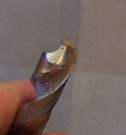

Here's a picture of the drill bit. I don't think I've ever have one quick this dull. When I cut the blank with my band saw, sparks were flying, so I hope I didn't ruin the blade as I only put it on two ago.

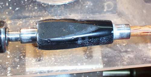

This is what the blank looks like so far. I polished it up a little bit with Abranet to see if it was going to be worthwhile finishing the pen.

Man, you really pushed that bit! [:0][:0][:0] Must be smoking hot by the time you finished. Good thing (or bad) that you didn't blow the blank right away.
You need to watch your tools more...I mean, I would have stopped long before they reached that condition (both drill bit and gouge).

You may want to use an old file to bring it closer to shape. It looks like you have a long way to go to turn that blank down. Good luck.

And got the blank turned down to size by running the lathe at slow speed and running my belt Sander up against the blank with 80 grit sandpaper. Then I used my skew to shape it somewhat. I'll put a picture of it up when I get it finished.
