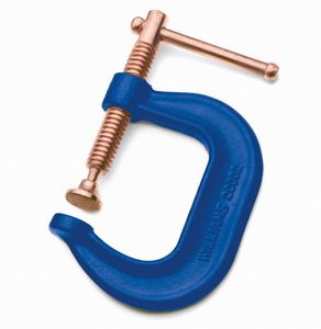

And what is a handscrew?
A large clamp that has a threaded press. Or at least that's my guess
I use one from Sears and ended up gluing pieces of a cutting board to it cause the pen was poking through the plastic ends
