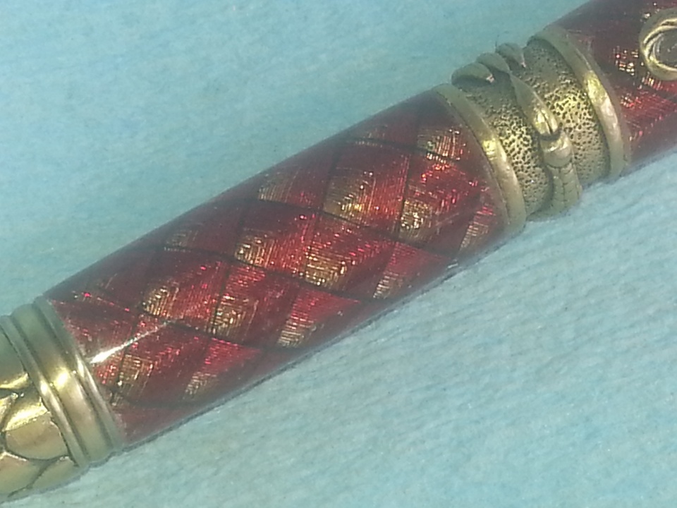

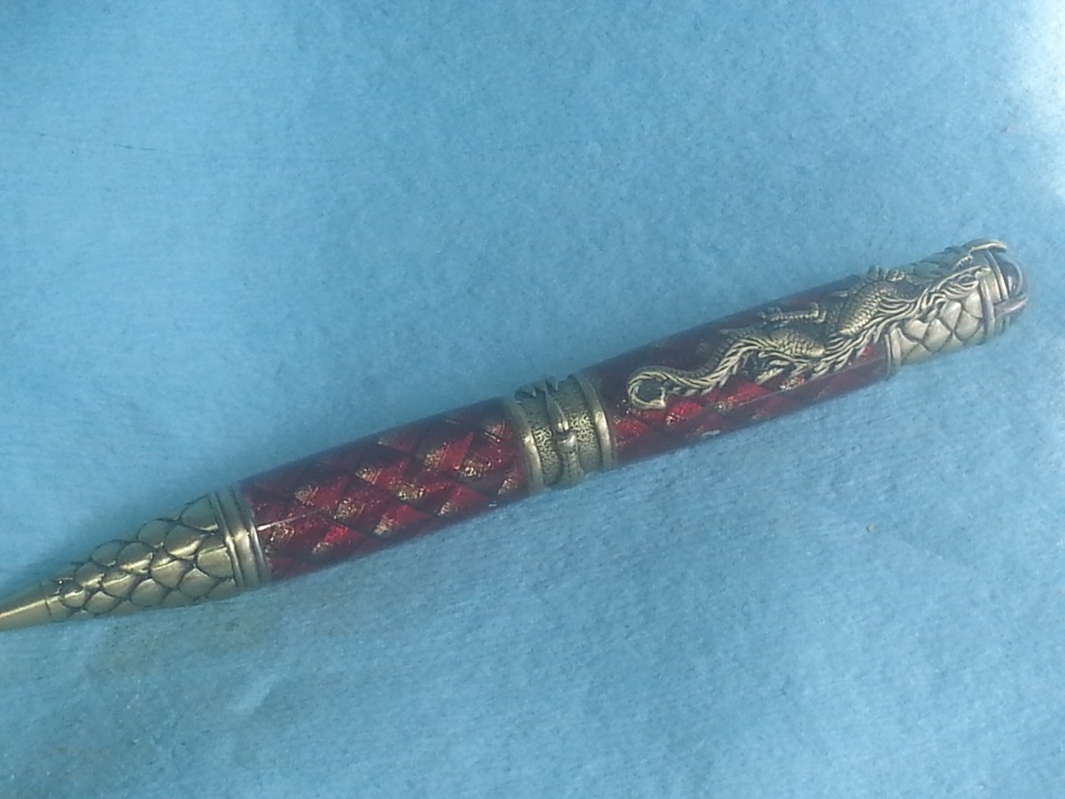

I'm glad to see there are others that are wanting to do thread wrapping for their pens. I've been in limbo lately as far as a place to work so I haven't been posting much at all. Well, actually, none since we had to move in with our son until we can get our place back home in Louisiana. That's a long story, but suffice it to say, you can't live on disability very easily.
I have been working on new patterns for cross wrapping and with a new program that I am beta testing I have come up with some pretty nice patterns that I can't wait to wrap. Just before we had to close up shop I did manage to complete one Dragon Pen that came out pretty nice, but since then I've developed a newer version of that pattern that is ten-fold better.

I used the Threadmaster high build rod finish (after using the ProWrap ColorFast thread) from mudhole.com. I just built it up larger than the diameter of the final pen size and then sanded/buffed/polished it.
Note - tried to put PR over the rod finish - do not try this. The finish and PR did not play well, and the threads were bleached. I have a few examples to remind me why I won't do that again...
As for the ends of the tube, after getting down to the correct length of the brass tube, I had some thread 'fuzzies' that were still there. A quick flame at the ends was just enough to burn them back to the brass tube (didn't leave it any longer than necessary - was afraid of what might happen if it got too hot).
Another suggestion is that you need a kit where the thickness of the finished blank is at least 0.1 inches. The kit shown in my picture is 0.06 inches from the outside of the tube to the finished size. The threads are just barely covered by the finish. My first attempt had carbon fiber weave underneath - not enough depth to pull that off with this kit.
Still learning - finding stuff out each time I do one, but they are getting better as I go...

I"ve learned to put my pen tube on a wooden dowel rod and build up the wood with masking tape at the end of tube so that I can start and turn around my wrap off of the tube on the dowel rod. Once you finish wrapping I use thin CA to bond it all together and then put a few coats of CA on followed by medium CA. I only use the NOCP thread and don't have to use color preserver on it and still keep the thread the right color with no bleed through. Once it's hardened good I take an X-acto knife and cut the thread about an eighth of an inch longer on each end than the tube. I then slide it off of the dowel rod and let it sit overnight. The next day I trim the ends flush and then put it in the mold and cast it in PR. This way works out pretty nicely. It took a lot of experimenting before finally coming up with a method that works, but this method works nicely. Make sure when you cast it you put it in a pressure pot so you don't end up with little bubbles.

The reason the dye ran in your thread was you didn't have a color preserver on first. I use thread that has already been treated referred to as NCP or NOCP thread. I use a brand called Pro Wrap because of the color choices it has. Fuji, Pac Bay and Maedera (SP?) are good brands as well, but the last one isn't already treated so you have to use color preserver on it before using the epoxy. The previously mentioned brands come as NCP, or regular nylon needing CP before epoxy. There are some differences in doing crosswraps for pens instead of doing it for fishing rods. I'm slowly but surely going over the way to do it for pens on my Facebook page.
