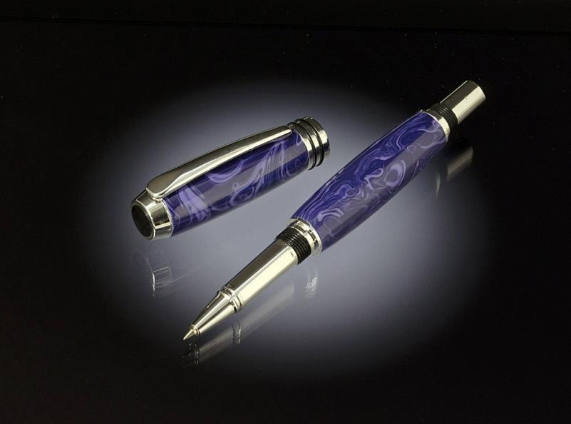

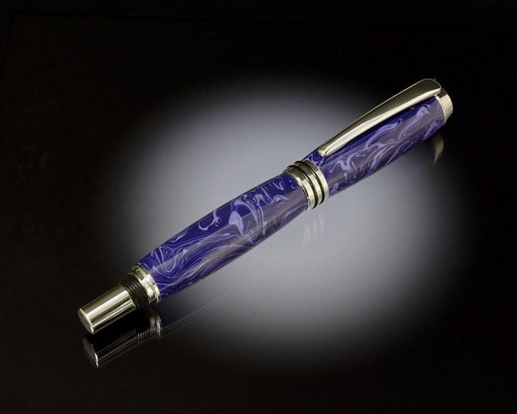

I wasn't sure if I should put this in Penturning or in SOYP, but considering that I've added a tutorial video, I'll give this section a try.
I've made several TruStone pens before, but this was the first time working with this purple version.
It's pretty brittle, so it was slow going, with very light cuts with sharp carbide tools.
It was a commission from my bride's co-worker, so it's nice to have it completed.
Also, the actual pen has more red and less blue than in these photos. It's a subtle purple on purple color. I'm experimenting with a rather unusual photographic setup/background suitable for small items... and this was my first test of the configuration. More to come on that later.
I documented photos of the step-by-step making of this pen, and turned them into a video tutorial so those who might like to try this can see how it's done.
Here's the video: Purple TruStone Rollerball Pen Tutorial - YouTube
The video has no sound because I thought that folk might be starting and stopping it often to look at details.
I hope folk find the photos and tutorial useful.

Great looking pen and I'll attest to that variety of Trustone being VERY hard.
After dulling my HSS Sorby skew in about 30 seconds, three times in a row, I shut the lathe off and went out and purchased my first carbide tipped cutter! Mine went on a discontinued PSI Designer Elite and just like your it came out really nice. Amazingly, as hard as this material is to turn, it sanded and polished fairly easily.

Great pen. Fit-n-finish is spot on!!
But the photo is doing something to it...a double vision thing(maybe it's just me) from the underside that pulls my attention away from the pen.
I will check out the video, and thanks for doing that too!!

I am partial to reflections under items in small product photos, and generally prefer them over shadows. It's not everyone's taste.
