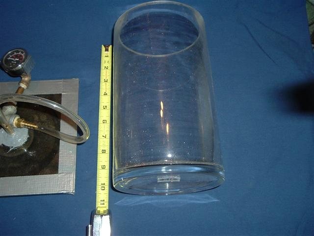

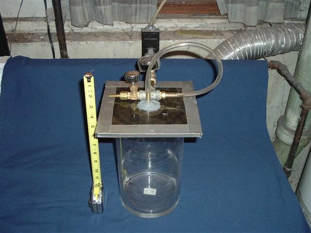

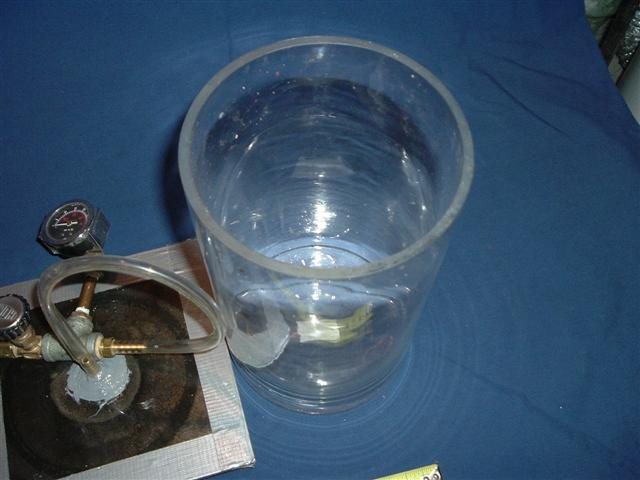

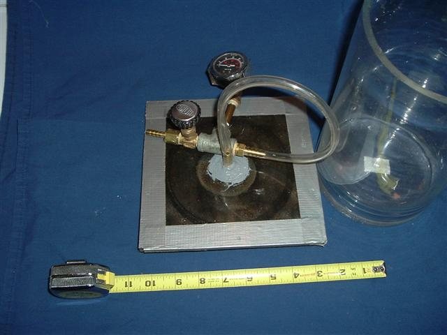

BTW Nancy, I now use a flower vase that I purchased from Michaels craft store for $9.99. A plexiglass cover and some rubber and I can put a 1 quart mason jar inside with no problems at all. here are a couple pics.

Great idea Mudder, I like it!!!
Please show a photo of the cover's other/inner side. Where did you buy the rubber?
