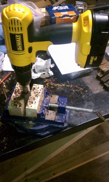

I started out trimming on the drill press. I would use a block of 1x to apply upward pressure and a crescent wrench to keep it from spinning. After I shredded 4 blanks in one day, I got a bunch of ideas from IAP members. Now I use my pen drill vice and a clutched cordless drill.
