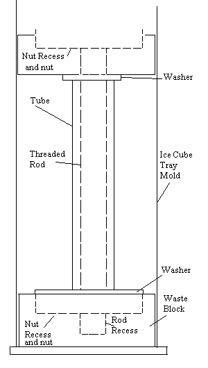

Actually, now that I'm remembering it (it's been at least six months since I've done any casting) an idea I had was to use nuts and washers on some threaded rod. If you coat the washer with a little petrolium jelly, paste wax, etc., it should come free pretty easily.
EDIT:
OK, here's what I had (kind of) envisioned. Remember that I do most of my casting in the ice cube trays. I like them because I can control the depth. In this set-up, the waste blocks are turned to JUST fit inside the ice cube tray. They act to give a little clearance from the bottom of the mold, and to help keep things centered. When the waste blocks are removed (assume they are coated with wax to help them slip into the mold, and to keep the PR off of them), you may have PR against the nut at the bottom, but if that's wax coated too, it shouldn't be hard to break it free. That only leaves the "washers" on the ends. If they are made of a sacrificial material (e.g. waste wood), or if they're coated with wax, they can either be turned/drilled out or possibly even pulled out.
Although this is designed for my style of casting, it should also work (or can be easily adapted to work) with the horizontal castings.
What do you think, Don (or anyone else)?

So Don if I understant correctly PR in your tubes is because you have a gap between the corck and the ID tube. am I correct? to weight my blank I put some fishing sinkers in the tube, for your cork ( I assume you cut them by hand so they are not perfectly round ) try to use the teflon tape to make a tight fit, I don't think rubbet stopper will give a better job but sure like you say will rise the price of the pen $ 2.00 more,
Jim your idea isn't bad but then you have to be carreful when tightne up the nut not to crush the tube as this will act as a vise.

Originally posted by JimGo
<br />OK, here's what I had (kind of) envisioned. Remember that I do most of my casting in the ice cube trays. I like them because I can control the depth. In this set-up, the waste blocks are turned to JUST fit inside the ice cube tray. They act to give a little clearance from the bottom of the mold, and to help keep things centered. When the waste blocks are removed (assume they are coated with wax to help them slip into the mold, and to keep the PR off of them), you may have PR against the nut at the bottom, but if that's wax coated too, it shouldn't be hard to break it free. That only leaves the "washers" on the ends. If they are made of a sacrificial material (e.g. waste wood), or if they're coated with wax, they can either be turned/drilled out or possibly even pulled out.
<br />
This is basically what I used when I cast my giraffe print in clear PR. It worked well. A few well placed band saw cuts and everything popped free. Gave all of the metal a pretty good coat of petroleum jelly. Just be careful not to have so much on the washers that it trnasfers to the tube or material on the tube. Oh, I used carriage bolts instead of all-thread, but same principal otherwise.
