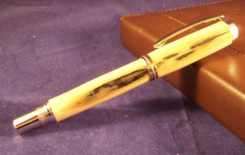

Here is a pen I made from Mammoth Ivory. I purchased the Ivory while in Alaska earlier this year. It is for sale and I would be happy to talk with you about it if you like.

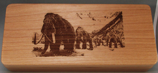

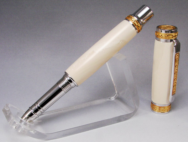

I did a couple mammoth Ivory pens for a Friend a couple years ago for having the Super Bowl party at his house. He is a Paleontologist. The pens are doing just fine. He says he wipes them down with mineral oil a couple of times per year. He said neets foot would also work. Here is one of the pens.

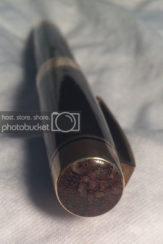

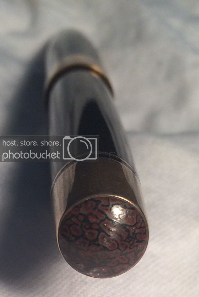

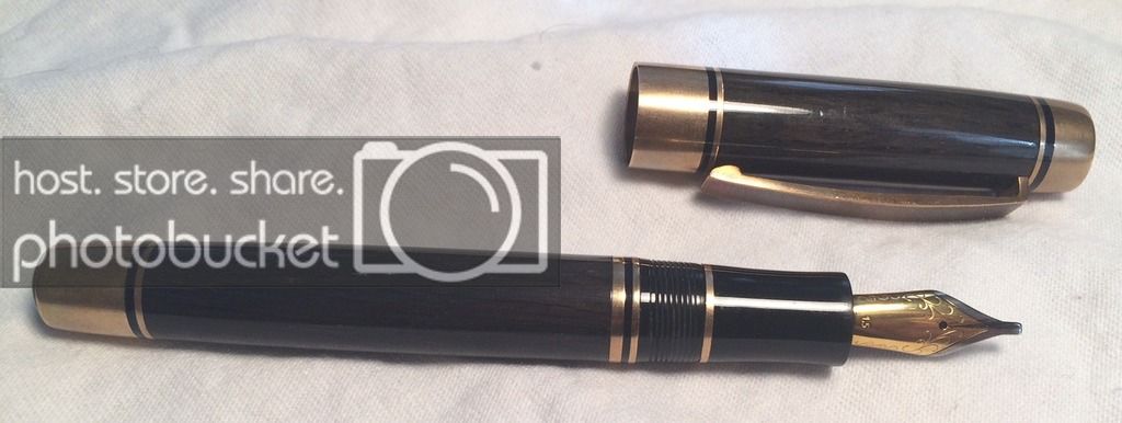

Here is a pen I made using bog oak, bronze, and dinosaur bone. It was a gift for my brother and was intended to have an ancient theme. Sorry the pictures aren't the best. I never took pics of it, and I had my brother send me some quick ones.
This was the first time I had ever used fossilized material, so I wasn't quite sure how to work it. I found that using a diamond cut off wheel in a dremel tool while the dinosaur bone was spinning in the lathe was the easiest way for me to shape the cabochons that I set into the finials. Dust collection is a must, as the dinosaur bone sent off some quite nasty dust. I had a shop vac hose set up right behind the spinning work piece so make sure the dust didn't find its way into my lungs. I hope this helps anyone who is curious about using fossilized materials!
