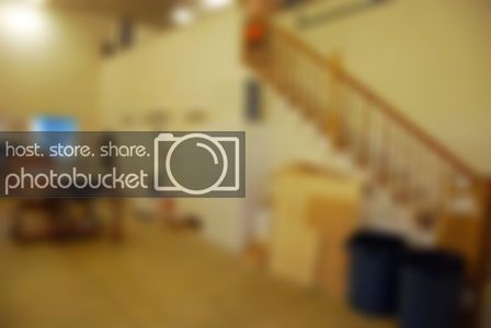

My shop at of late June 2016
Ok OK Here are photos as it exists today. First, pinch me, second I think OMG each time I go in the door and work. After 39 years in a wonderful, but cramped 1200 sq ft Long Beach home with a two car garage that housed my shop, this is my new reality in Bear Valley Springs, Tehachapi.
The shop outside

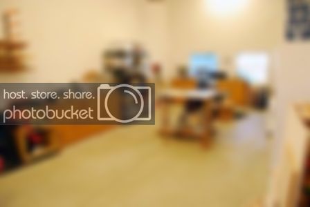

Whole shop from the garage door

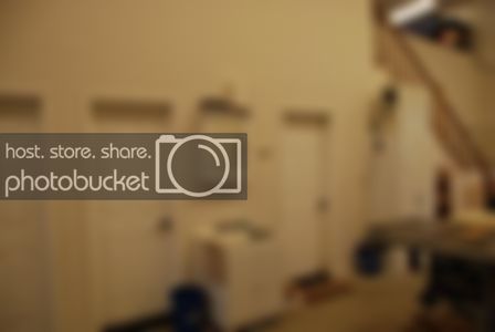

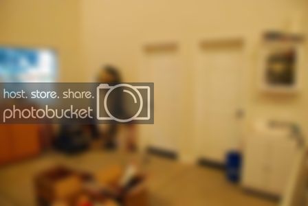

Lathe, planer, compressor, bandsaw, part of a workbench, dog bed and yes target for the pellet rifle.
The other side of the shop with those three doors, the staircase and my Jet air filter sitting on the finishing cabinet.

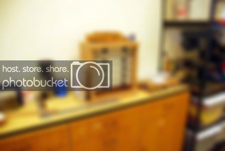

A very customized long range tackle box in progress.

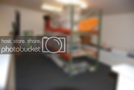

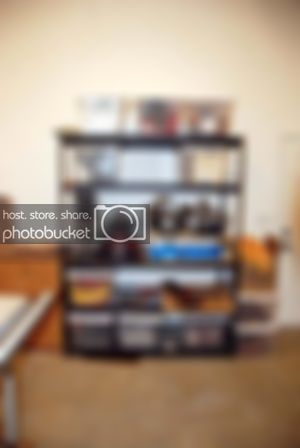

Storage rack

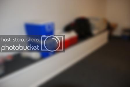

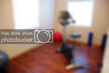

Behind door number one is a gym! I worked out here this morning and try to most days.

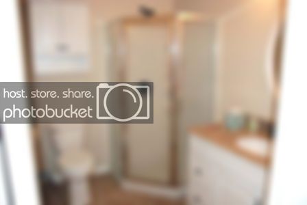

Behind door number two is a bathroom with a shower.

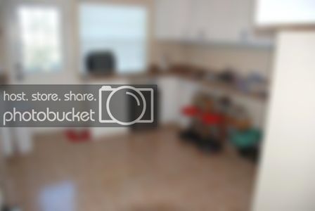

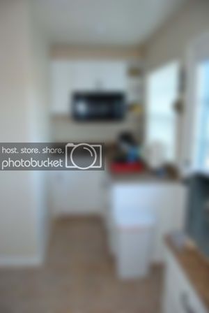

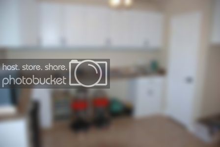

Behind door number three is a kitchen/finishing area where I also store most of my fishing equipment.

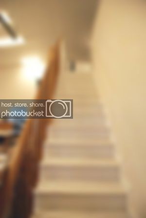

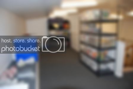

The stairs up lead to a very large storage area for non-woodworking stuff

The shop has the square footage of my entire previous home. Needless to say, it was impossible to hide my enthusiasm when we visited this home and I saw this space. I have much to do to grow into and utilize this wonderful work area. I will make a serious effort at dust collection.
Someone stated that I might be blowing the air exhausted from the Jet upstairs, not so. If I stand right next to my table saw, near the sink, I feel the clean exhaust air well. You cannot feel exhaust air at all on the stairs. I always close those doors during any work to keep dust from entering these rooms.
Color me very fortunate and happy with life.
