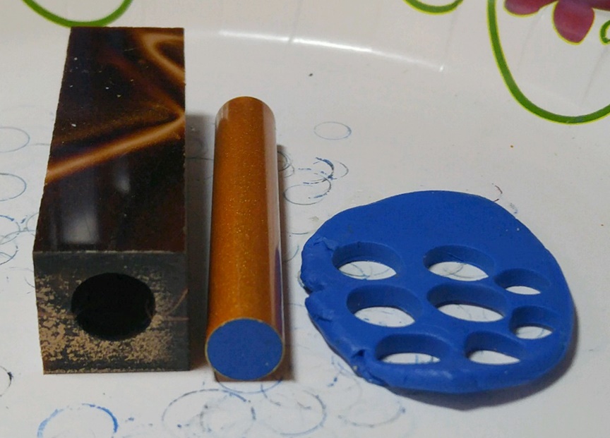

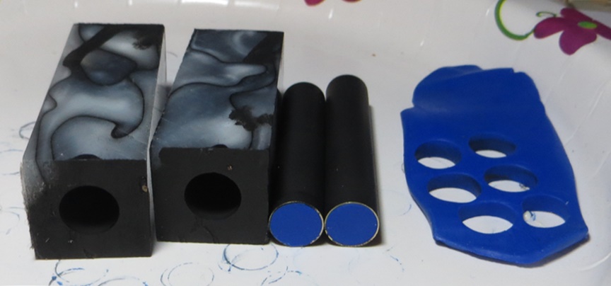

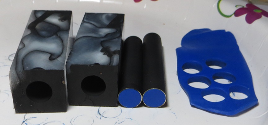

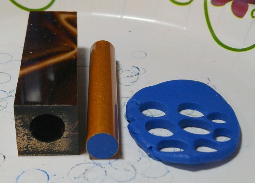

Over the years I've tried many things, including potato and dental wax. But I've found that modeling clay from Michael's works best for me. It doesn't harden, and is just the right consistency. I roll it out to about 1/8" thick with a piece of PVC pipe.
Plastalina Modeling Clay by Craft Smart®
