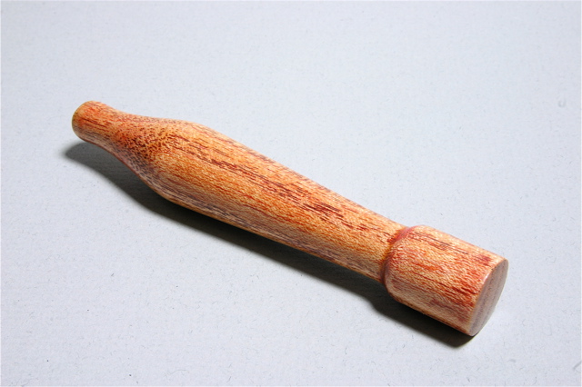

I actually make them in a variety of ways. Some are all wood, turned on the Jet Mini. Some are all metal, turned on the South Bend 9c. Some are pure freehands, ground away on the belt grinder.

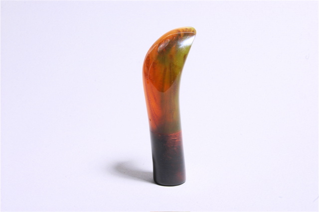

On Friday I made one to go with a pipe from processed locust, then dyed it and polished it to get an interesting effect:

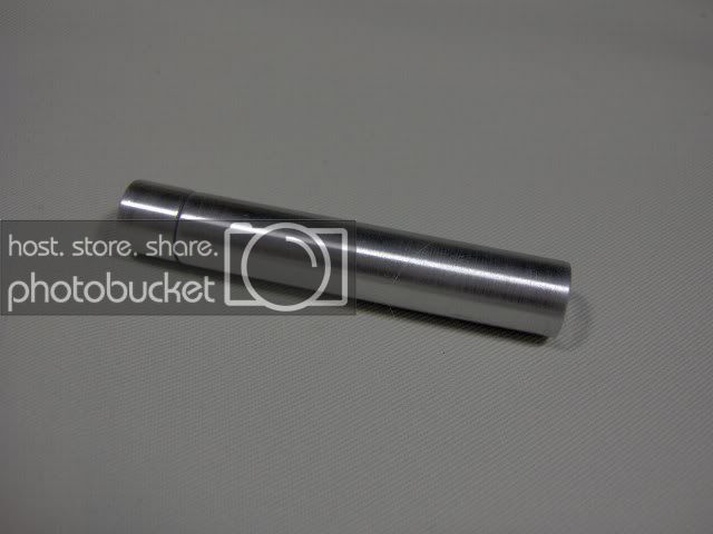

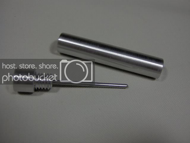

Here is one that is a proto type of a brass one that I made for a friend. This is all aluminum, the "blank" was 1/2" rod that was drilled out threaded and the pick was 3/32" steel rod. All the pieces screw together. I wish I had a photo of the final brass version, it was a lot better looking than this one. It was all made on the Jet mini or my or my Delta, using collet chuck, Jacobs chuck, and a die holder to get everything lined up.
