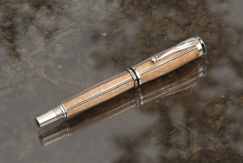

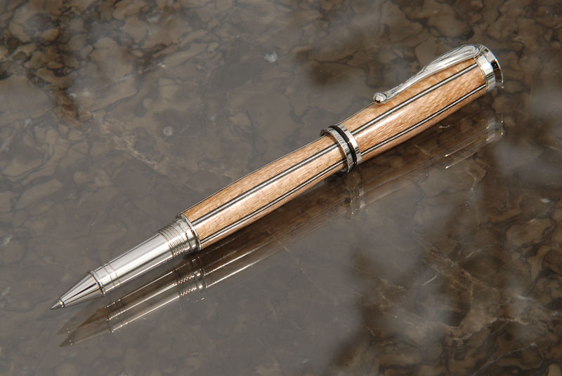

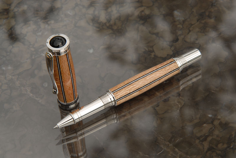

Jr. Retro dressed in silky oak and dyed veneer pinstripes. The pattern repeats six times around the blank, so the stripes line up, capped or posted, regardless which thread is started.

Nice job as always Keith. How wide are the six stripes? Is it narrower than 3/32"
Mike
Thanks Mike. It's not what you're thinking :) Once I had made the six sided blank I used a jig on my table saw to hold it safely and securely. The stripes are around 1/16". Freud Diablo circular saw blade. A pass through the drum sander with the center veneer and the three pieces of veneer fit nice and snug in the saw kerf.

can't get more clever than that...getting them to align is pretty close to genius

I made an "8" pin stripe a couple of years ago and the second blank came out perfect. I did mine exactly like yours. Then the next 5 tries ended in something being out of balance somewhere, or a kerf too wide. I tried it again last summer and the same problems.
IMO, that is the hardest pen to make and keep everything in proportion!
I am will try it again this summer. My hat is off to you! I just can't seem to get it perfect anymore. GREAT Work!
