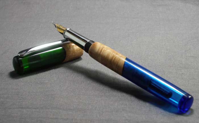

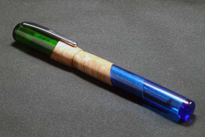

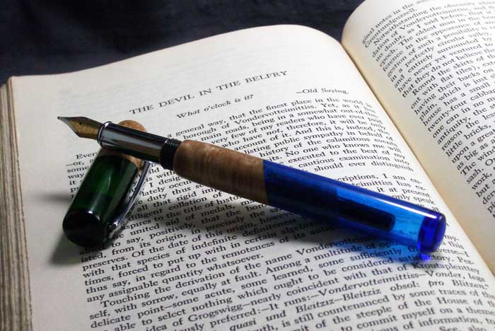

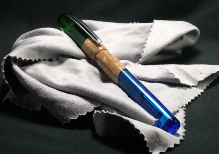

I participated in the pen/puzzle swap over on the eagle forum, and I got paired up with Keith. He sent me an awesome feather pen (http://www.penturners.org/forum/showthread.php?t=42906) and a very beautiful koa and aluminum blank that is currently on my lathe. In return :biggrin: I sent him this pen.

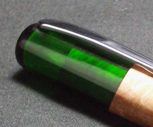

I have to say this pen was alot of fun to make, but the first few tries still lay on the shop floor. The pr came from http://exoticblanks.com of course, and the wood is ribbed fruit malle burl from scribblesticks. the kit parts are out of a Barron/Navigator. It's hard to see in some of the pictures, but the burl continues up into the upper and lower tubes. I've included a close up where you can see the grain.

Really neat innovation!!! I would SUGGEST you make the junctions square (not on an angle). Just because the "screwed on pen cap" will be out of alignment with the bottom two times out of three, due to the 3 start position of the cap.
With a "square" transition, it will always look right.
FWIW!!! Great job of thinking and executing something new (to me).

I thought about making the joints straight across, but since I was making it for a fellow pen turner, I thought the diagonal cuts would be a bit more complicated. So i guess it was a bit of a trade off.
To do this particular pen, I had to turn each different piece and then assemble them. You can't see it in the pictures, but the burl grain lines inside the tube matches the burl outside the tube.
Ed, the pen is based on the Sedona/Baron/Navigator which has a two start thread, so you get the alignment correct half the time :biggrin:
As Ben mentioned, it is a trade off, and something I have to deal with on some of my designs. I think the aesthetics of the design more than make up for it though.
