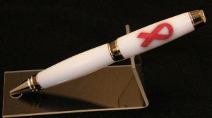

This is one I did a while back it is Pink Ivory cast in white PR.

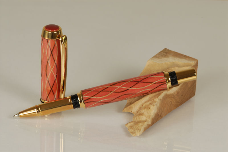

If you are able to make the kinds of laminations that Keith makes, you cut down the chances of cracking, since the wood is already cut in many places. (I can't do that - it's a TALENT problem)
