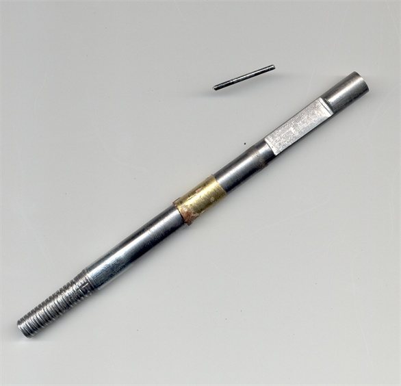

I have been doing a few closed end barons. For the first 5 or 6 I used a dowel chucked in my PSI chuck with a section turned down to the diameter of the smaller baron bushing then the rest of it the size of the I.D. of the brass tube. It worked fairly well but when I separated the waste of the end of the closed end form and lost the ability to stabilize everyting with the tailstock it got a little wobbly. I don't have a metal lathe so I have been trying to figure out what to do a bout a nice stiff pin chuck.
Well, I was trimming the blanks ( I bought one of the trimmer kits with the multiple inserts) and realized the largest trimmer fits snuggly in the Baron brass tube. So I threw it in my drill chuck body, filed a notch, grabbed a small nail and filed and trimmed it. Presto! Solid pin chuck and it won't affect the use as a trimmer insert. The cool thing is I can do the same for all of the other inserts!

/just an idea but I made mine by cutting the head off a bolt chucking it in my drill press and going to town with a file. slot for pin was cut on grinder and cleaned up by hand with a file. Cost about 48 cents.

I've made two so far. The first one was from a bolt and is used for bottle stoppers.
The other is like Mike's, although he has a better touch on the grinding wheel than I do.

Ron,
The only thing the grinding wheel was used for was to cut the slot, and my "touch" was not even good enogh for that I had to file it quite a bit to smooth it out. By chucking it in my drill press and working a file up and down it while it was spinning I was able to get it to size and get it round. It got hot pretty quick but I just let it cool down and went to do something else. It was the perfect side project to do while let stuff dry or drill bits cool down, ect. I just wish I had a collet chuck to hold it in though it does not run as smooth in my Jacobs chuck as I would like, pretty goos though.

I used a Jacobs chuck in my lathe to size down the 1/4" HSS pin using the same method as you. I also marked the chuck and the pin so I can always align them up the same way. It runs true.

is it just me or what, I cant seem to understand how that works and how a pin in the flat slot with tube over it works or holds the brass sleeve from free spinning[?]

cause the pin in the same size when placed in the middle of the slot only as in rolls to the edge of the slot it is bigger than yourtubes inside diameter. When you twist the tube the pin jams against the inside of the tube.
