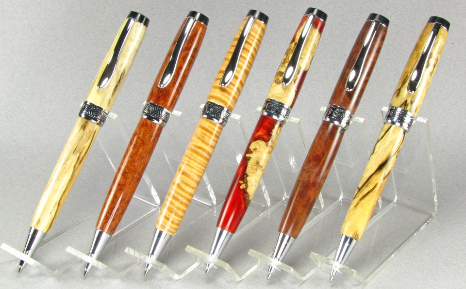

Mack C.
Passed Away Sep 29, 2018
In Memoriam
May 4, 2008
2,019
Brooklin, ON Canada
Here's a few of many I have turned without a single problem!
This above bunch are all Chrome plated, but I like the Ti. G & Blk. Ti's better (below)!
