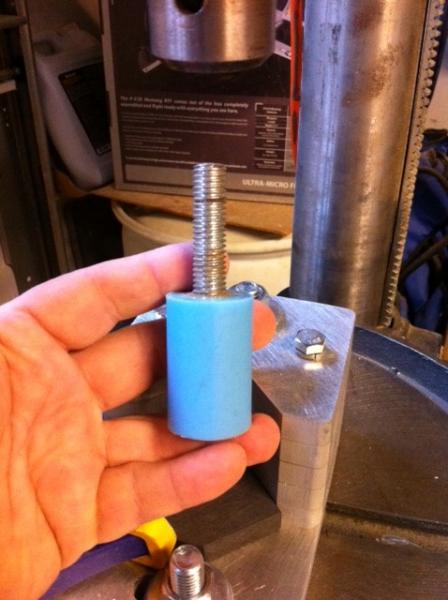

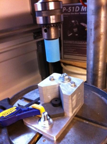

I made an attachment for my drill press. I took about an inch and a half of UHMW 1 1/2" round stock, drilled a hole just deep enough to thread a bolt in one end of it... Cut the head off the bolt and cleaned it up... Then I faced the working surface on my metal lathe for a clean look.
When its time to assemble, I chuck my homemade tool up in my drill press and place some hard (non metal) material on the drill press table and use this as my pen press.
I even have die's to hold the nibs so they don't get driven into either surface when pressing.
I call this one of my finer moments of NW hillbilly engineering.

I originally set out to make a standalone pen press but found I like the control that I get from putting it in my drill press and using it this way.
