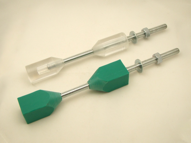

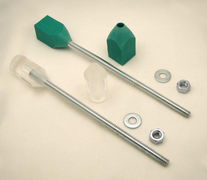

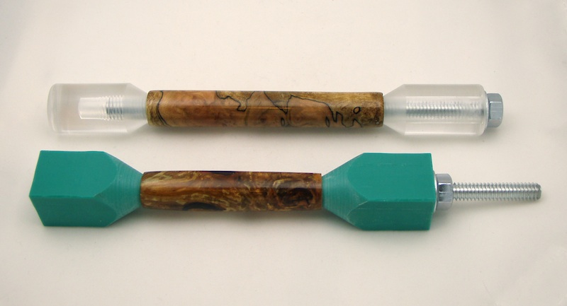

The rub fill I have seen is like a wax and doesn't dry hard. Most of the pens we had laser engraved by a trophy shop we left without a fill. Those that did get filled did not get more CA.They got our normal CA finish (couple coats of thin followed by 10 medium, sand with 400 and then Beall buffed). We did not assemble the pens before engraving, that came after. There may be other ways of doing it but that's what we did.
I'll attach pics of the tube holders we provided the guy. One was for his rotary holder and the other for single lines of text.
