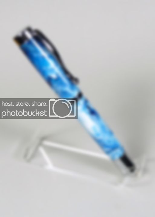

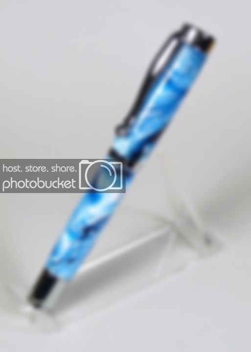

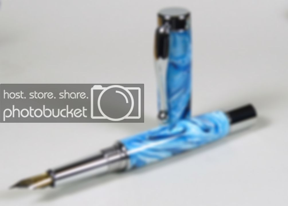

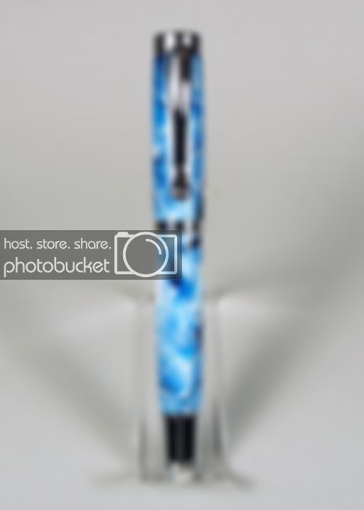

I know a lot of people like a little curve on their pens and all I've done lately have been mostly straight or almost straight tapered. I thought I'd leave a little curve on this one so we could all see what the Atrax looks like that way. The kit is the chrome fountain pen from Exotic Blanks. The blank was picked up at the Sept 2011 Atlanta chapter meeting and was created by Jonathon Brooks (surprise! :)).
Reverse painted black and polished out with the Beall buffing wheels.
Questions? Suggestions?
Earl

Love the coloring in the blank!!
Was wondering how far into the grits you sand with before getting the blanks on the 'wheel'?

That's a beauty for sure. I think the smooth simple lines on that pen model allows the Brooks blank to really BURST to make a really nice looking pen.

Scott, I've been turning to within about 2 thousandths on a little metal lathe. Stopped at about 15 thousandths from the bushings if I remember on this one. Then I used 400 grit hook & loop sandpaper on a piece of plywood to round off the ends on this one. From I generally use mm 1800 to 3600 to get all the sanding groves out. It's about half and half between sanding with the lathe on and sanding side-to-side with the lathe off. Check it with a magnifying glass for scratches or irregularities. Then I use the Beall bowl buffer with White Diamond mounted in a drill on the blank with the blank spinning on the lathe. Just a few seconds and the shine just pops up. I then dismount it and use the White Diamond on the buffing wheel mounted on the lathe to just take the edges off the end of the turning. Hit it a few seconds with the Beall wax on another wheel and it's done.
I find this much faster and better than going all the way through the mm to 12000.
Earl (guess I'm lazy) D
