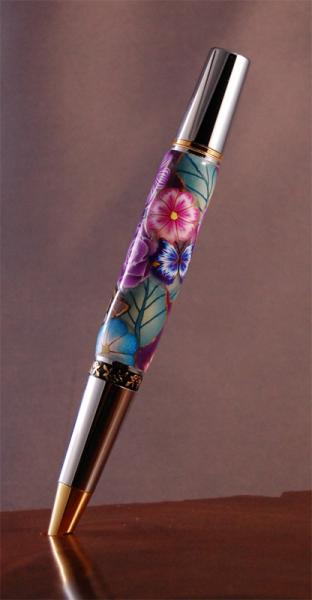

OK, what am I doing wrong (or not doing right)?
Did my first pen with Toni's canes, thought it looked "OK", then I see Toni's "In the Beginning" thread, and now mine looks like a turd! :mad::frown: (no offense intended to Curtis and his "Original Cat Turd Blank" ™ :rolleyes: )
Mine:

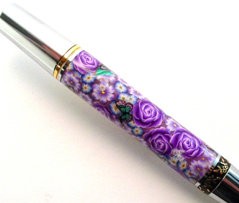

Hers:
Note the fat rounded ends on mine, and the clean smooth end on Toni's.
Soooo, first, I'm guessing, I don't need as thick a base layer on my tube. Second, I need to lightly roll the decorated tube until the diameter is closer to the bushing size, getting rid of most of the lumps between my flowers in the process.
Another question I had for Toni - I used Fimo for a base layer, and it says to bake at 230 degrees, while your Etsy site says the canes should bake at 265. Thoughts on handling the gap?
Oh, and your Etsy site says "Recommended baking time is 275 F or 130 C." That might be the baking temp, but not the time. I guessed 30 minutes for the time...
So, help me out folks - what do I need to do to improve!

Thanks for the feedback, folks, but I'd still love to hear from some experienced PC users to figure out how to improve.

Thanks Dean. I only bumped it because I'm on limited shop time this weekend and was hoping for some tips/answers before tonight.

Hi Steve ~ sorry was asleep time difference and all:biggrin:
Yes the base layer needs to be thinner. That is really all I can tell you, because its a great looking pen!!!
I only pretend to be a PC expert, Keith (creativewriting) is the True expert:eek: IT DOES NOT LOOK LIKE A TURD!!
As for the temperature the main temperature you should be concerned with is the cane temperatures, 130celcious or 275 for 30 minutes is what I recommend with an aluminum tent over the piece.
Other than that Great pen as I said, keep at it and in no time I can retire!
