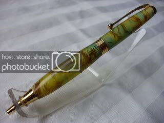

I haven't tried White pine, but have done Sugi, which is Japanese Pine, if i'm correct.
It was a nice one to turn, soft though, take it easy on barrel trimming. With this one, the sister blank ended up coming apart at the growth ring line, near the end of the blank.

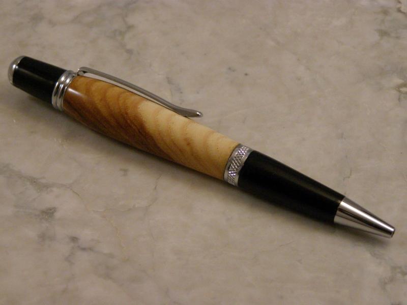

White pine is soft, plain, and one piece is pretty much indistinguishable from another.
If it were me, I'd find something else with more meaning to your pastor and make a pen from that.
Other types of pine are much nicer. The pen shown below is Antique (Old-growth) Heart Pine and came from reclaimed timbers turned on the bias.
Notice the tight growth rings and rich patina. :biggrin:
