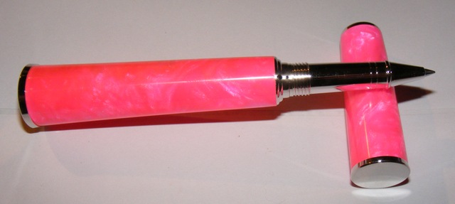

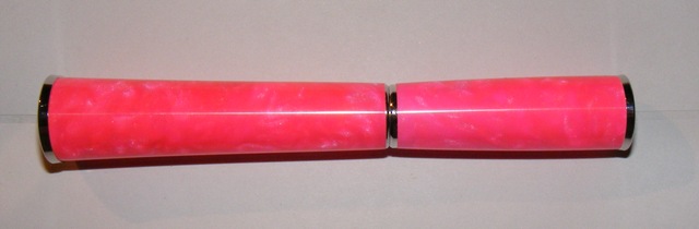

My wife disagrees. Here's her Purse pen.
ExoticBlanks Bubblegum on a Platinum Panache.

Mike -- we obviously have different managers -- with different purse styles. That is why I cited the source --
I think your picture makes the point that this can be a dramatic pen that makes a statement.
