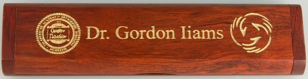

You mean like this?
It's a PSI rosewood box engraved and filled in gold. The color fill did get in the pores, but wiped out with a damp cloth.
