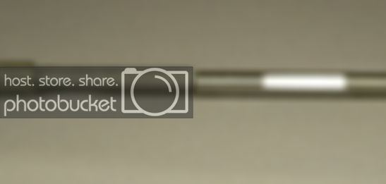

Dan_F
Nov 8, 2007
959
Spokane, WA, USA.
Here is a little more info. Run out at the dead center is .0005; here is how it was measured...
https://i98.photobucket.com/albums/l279/T-Caster/P1010790.jpg[/IMG
What is an acceptable amount of run out for a lathe?
Here is Lee's ruler method of checking alignment of head and tail stock. This is about 5 degrees off of perpendicular to the center's axis, as measured with a protractor. I have no idea how to fine tune the alignment, it's not mentioned in the owner's manual.
[IMG]https://i98.photobucket.com/albums/l279/T-Caster/P1010794.jpg
I'm now off to make some sleeves for Lee's sanding mill which arrived earlier today.
I sent some readings from the bushings off to John to see what he had to say. I Should hear back tomorrow.
Dan
