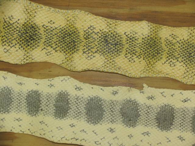

An interesting subject:D. This pen is made from Australian Sea Snake and the blank was cast by my friend and one of our IAP members, Serge. The resin was bubble free, crystal clear, and was a dream to turn. Maybe Serge will share with us how it was cast. I'm quite certain the resin is polyester resin. Thanks mate for a beautiful blank. Serge has a pen from this skin, I now have a pen from this skin (and a piece to cast myself) and we are waiting to see pen #3. Hey 3, you still around? Turn yours and show us #3. I'll let you wonder who #3 is...maybe he's still on the golf course or at the car auction, or maybe living in the car he purchased after his wife found out. Enjoy the pen and THANKS again Serge! Get busy #3!

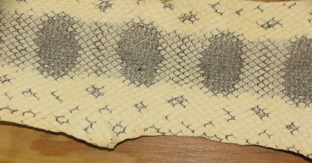

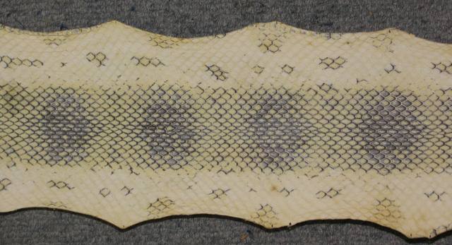

Well done Don, look great another pen to add to your personal collection, Yes the casting is polyester resin I add 4 drops of mekp per ounce as our ounce here is a tiny more than the US ounce, as to explain the process of PR I think you did a good tutorial and members should read it, the only difference is that you vacuum the PR at the first stage, I pressurized the PR, it return the same no bubbles then pressurized at 25 psi, may be #3 will chime too[:D]
oobak, Thanks for the comment, here's something for you to read
http://tinyurl.com/3yo8hr
as to cancel a Tennis match is alright when we have 44 degree who is 111.2 F, Sea snake skin I got was in length of 1.5 and 1.8 meter ( 54" and 60" less now [:D]) thickness of the skin is nearly twice the rattle snake skin at 0.52" if you need more info pm me off line

Sorry forgot, the only things I see after casting is that the scale patten of the skin darken with the PR I think the mepk as to do something about it, it happen to my fish skin too
