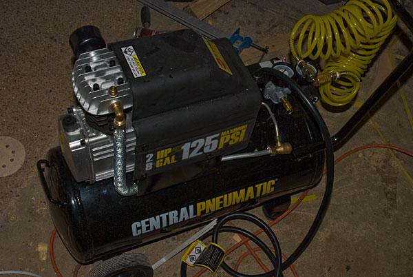

Went shopping yesterday at HF. Bought a compressor and a pressure pot. $150-ish for both. I love me some coupons!
This compressor.

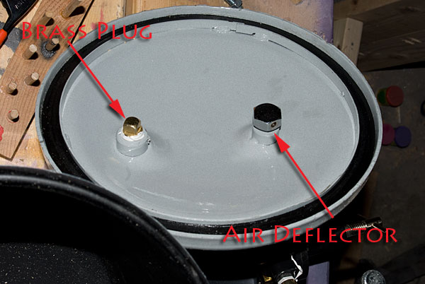

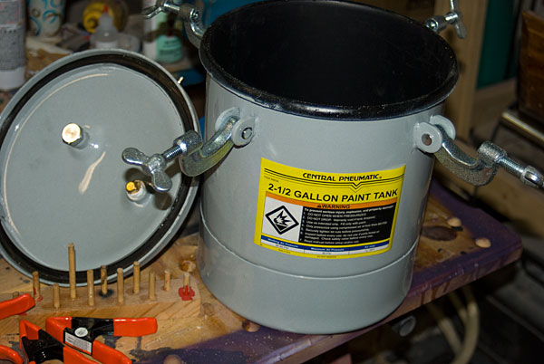

After pulling the pickup tube out (it just unscrewed for me) and plugging the hole, pulling and re-taping all the fittings, cleaning up the seal, etc, the tank held 40psi overnight. And, (this blew my mind), both gauges match! When the compressor outlet pressure reads 40psi, so does the pot!
Couple things are different between this pot and the older ones I've seen. As I said, the pickup tube just unscrewed. The outlet for the air has a deflector that throws the air to the sides instead of straight down. Didn't have to replace it with an elbow.

The pressure pot:
The lid with its brass plug. (The pickup tube was easy to unthread... Hmm...) Mine also came with an air deflector. Sweet.
The compressor:

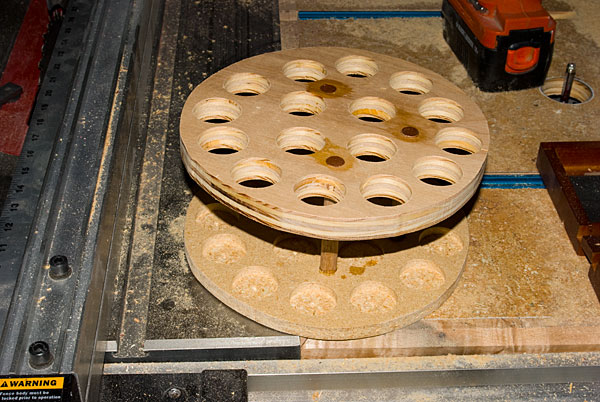

And the quick and dirty insert I just made to hold my pipe molds:

It's been too cold to cast without pressure. I can't keep the resin warm long enough to make sure there are no bubbles. :mad:
