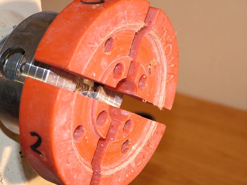

Nova makes a set of soft jaws and I use them to hold the blanks. They're
made of nylon instead of steel so they don't cut into the blank. I put the
blank between the jaws, not in them. (does that make sense?)
I never finished cutting this set. You mount them on the chuck and then
you cut them to the size and profile you want. I think they were around
$15 or so for the set.
