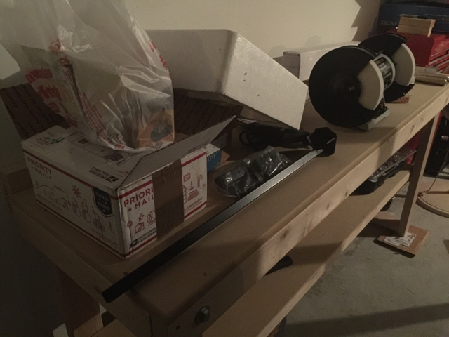

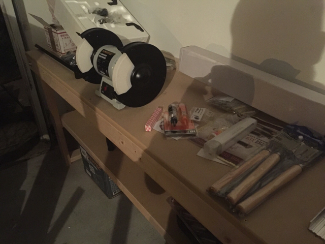

Thanks for the kind words. Getting the grinder where I want it will be job 1. I will need to elevate it to use the sharpening jig. A 2x8 or something similar should do but I need to source a small portion of one and not the whole dang thing. I'm going to see what I can find around the house. Truth is, I am a complete idiot with all things mechanical. I own very few power tools, and for good reason. This venture in to pen turning will help me become more hands on with things I hope. I have a lot to learn. I am afraid to rush anything to in hopes to minimize my risk of injury and frustration.

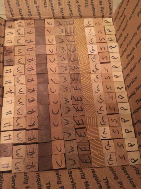

I bought the big box of blanks for $40, shipped. I figured they'd be good cheap practice at 26 cents a piece. Hopefully that will be the case and I can get decent use out of them as well. On the stuff coming Saturday, I have extra sets of tubes as well. I'm hoping to not sacrifice too many actual pen parts for the sake of learning, but I know I will.

From the pictures, it looks like you went with the wolverine sharpening jig (or similar) and 8 inch grinder. I have the same setup and only needed a piece of 3/4" plywood to elevate the grinder. Construction lumber would put it too high I think. Also make sure you have enough room behind the grinder for the movable arm with the tilting platform to get close enough to the grinding wheel. I ended up putting mine on a small cart next to the lathe with drawers underneath for other supplies.
Don't be afraid to move things around. Most people's work space looks nothing like how they initially set things up.

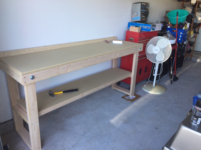

Thanks for the tip on the 3/4" plywood. I appreciate it. I was talking to the wife about getting the stand for the grinder, but I am not sure about that yet. I may mount the grinder on the end of the bench and rearrange some things for standing room. We're in the process of cleaning the garage out as well so space will become a bit more available with time (hopefully!). For now, it is nice to see the pieces of the puzzle starting to arrive. That puzzle is nowhere near together though.

Check local places that do countertops and see if they have some off-cut materials you can use ... a section of melamine coated MDF or particleboard would be nice and flat, even spill resistant. :)

Welcome from KC! Very nice shop! I just finished built a 7' long workbench for my shop last weekend. Mine is a slow work in progress as well. Can't wait to fire up my new lathe this weekend and get started on some beauties! :biggrin:

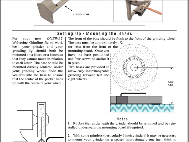

On your grinder. Make sure you read the instructions for the wolverine grinding jig. You are required to have the centerline of the wheel a certain distance from the bench.
In my case I use the raptor set up jigs and they specify 6 1/2" to the center line.
It's a great tool to use once you get it set up. Take the time to set it up right so you don't fight the tool. It will be much easier to learn to sharpen if that's all you are concentrating on.
Make sure that you have the room to insert the long sharpening jig bar all the way into the setup. You don't want to mount it all nice and perfect only to find out the bar hits the wall behind it. It's a long bar.

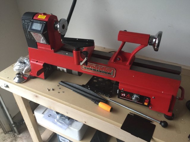

Sure wish it came assembled!!
Sent from my iPhone using Tapatalk
Honestly....it is! :biggrin: Nothing in that picture other than the tool rest is technically required to be on the lathe to make it work.
Welcome and good luck. Watch a ton of YouTube videos.
Hehe, guaranteed it wasn't when he got. That's the same one I have and you have to put it together from the bed up.

Did a good job so far putting it together ... only really missing the handwheel that goes on the back of the headstock, that allows you to easily turn the spindle for indexing and other various purposes.

This came in one box. It wasn't fully assembled but mostly so. There are a few pieces I was clueless about but some I have figured out from watching videos. I have a lot of organizing to do after I finish. I am out of town part of the weekend so I may not start turning for a little while. Time will tell.
