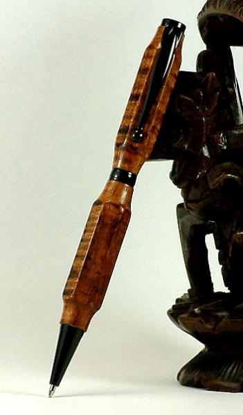

PenPal
Nov 29, 2006
2,708
Canberra, A.C.T., Australia.
Original Post Subject
Tasmanian Blackwood Pen.
Kind regards Peter.
