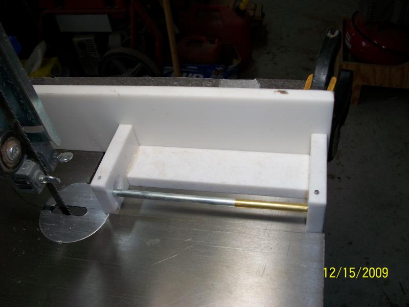

I had problems drilling in the center after segmenting. I made a jig so I can drill, then trim the blank to center the hole. After that I do the segmenting. It has worked great so far. The major issue is drilling in the center so the segments turn to the same size.
pmpartain
Apr 13, 2006
232
Fayetteville, AR, USA.
Rick, how do you trim after drilling? Do you have a locator for the center hole use the track for the miter gage or something? Are you segmenting after you drill the hole? That is a very good idea! My drilling jig always hits the center of the blank at the top of the hole, but somehow does not go parallel through the blank. I suspect there is some mis-alignment that happens when I clamp the blank into the vice. I have checked and re-checked the table alignment on the drill press and that seems ok. I guess the bit could wander, but I was working with the cigar kit and using a 10MM bit. I don't think that could flex and wander much. The drilling vice is firmly clamped to the drill press table also. I chuck 3/8 solid rod in the drill press, clamp that rod with the center drilling jig, and bolt the jig to the drill press table. Still the problem persists.
AceMrFixIt
Oct 1, 2008
625
Jacksonville, FL
I will post some pics for the jig.

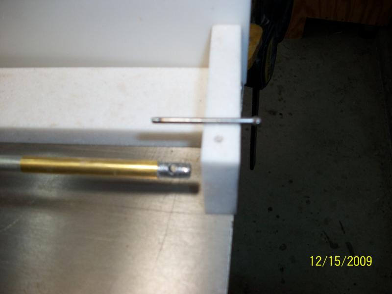

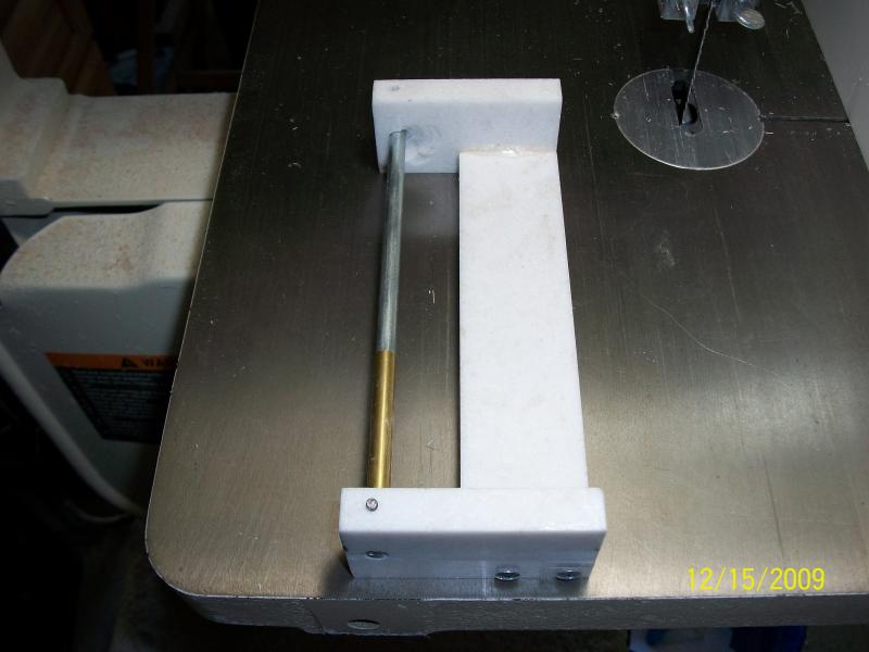

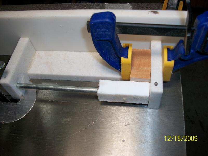

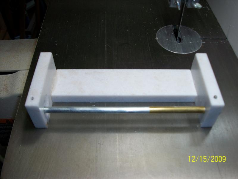

This is what I use to center the hole for the knot. Can be used on table saw or band saw. I set this one up for 7mm.

pmpartain
Apr 13, 2006
232
So you drill the blank. center up the hole on this jig, do the segmenting. drill out the hole again, and then turn? That is an approach I never thought of. Did I get that sequence right?
