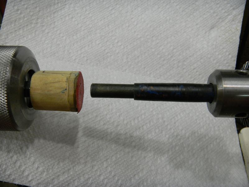

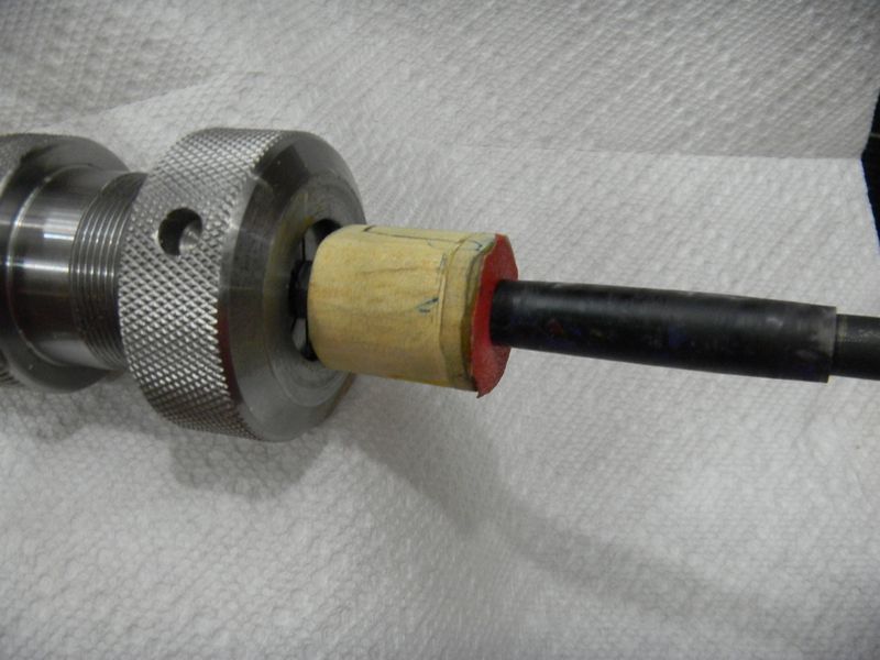

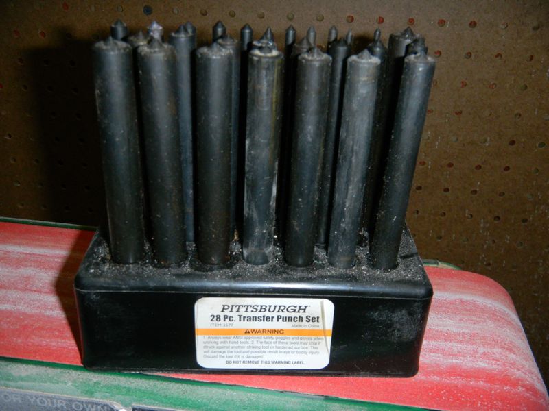

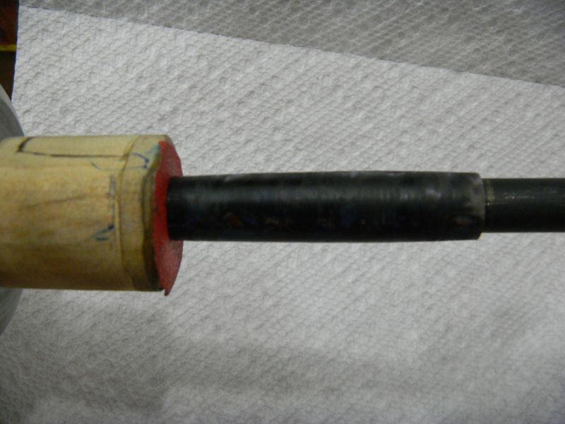

Using a piece of 1/4" all thread, scrap wood and sand paper - I made this blank squaring jig. I also bought a set of punches from HF for next to nothin. I have just about every size mandrel for every blank. A collet chuck holdsthe sanding head and a Jacobs chuck holds the appropriate size mandrel. They are square every time. I also use it to lightky sand after a CA application to remove excess CA.
Good Luck

When all else looks like it could fail, I do what Lynn suggested. You don't need to have a collet chuck ... A faceplate with adhesive backed sandpaper will work.
The punch set is an essential tool for any Penturner ... At least if you make mistakes like I do. :biggrin::)
