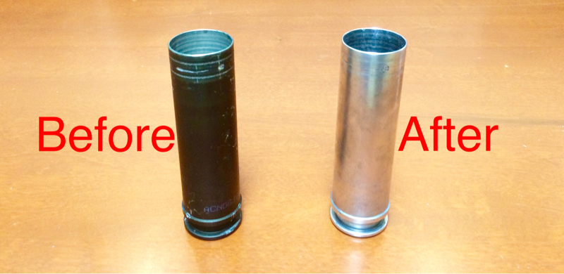

Hello,
I managed to get my hands on a couple of 30 mm shell casings and I would like to repurpose it but it has the green paint coating the aluminum shell. My question is how would I go by removing the paint so I can expose the aluminum? Once I get that i will need to buff and polish the round. Any advice on this will be welcomed as well.
Thank you in advance for your assistance.
Edgar

If it is anodized, I would try something other than sanding. I found several sites claiming that Greased Lightning cleaner works for such things. Here's one that looks promising:
Removing Anodizing From Aluminum Quickly and Easily.
I have no idea if this will work for your cases, but it might be worth consideration. As for all such things that you find on the Internet - caveat lector!

That coating is probably anodized. I'm not sure what health concerns it might cause when sanding, but I would recommend a respirator!
Do you know of a safe way to take the anodized coloring off?
Normal oven cleaner should take it off. Do it in a well ventilated area or outside and use rubber gloves. There is a lot of posts about using oven cleaner to remove anodizing

I found some videos on YouTube about that but I've soaked it for 10 mins each time so fare but only a little came off.
Exabian
Oct 26, 2012
266
South Korea (Camp Humphrey)
Got it! I forgot one part which was to wipe it down, I was just submerging it in water. Any it's looking good now. Just need to clean it up more an polish it to mirror shine.
