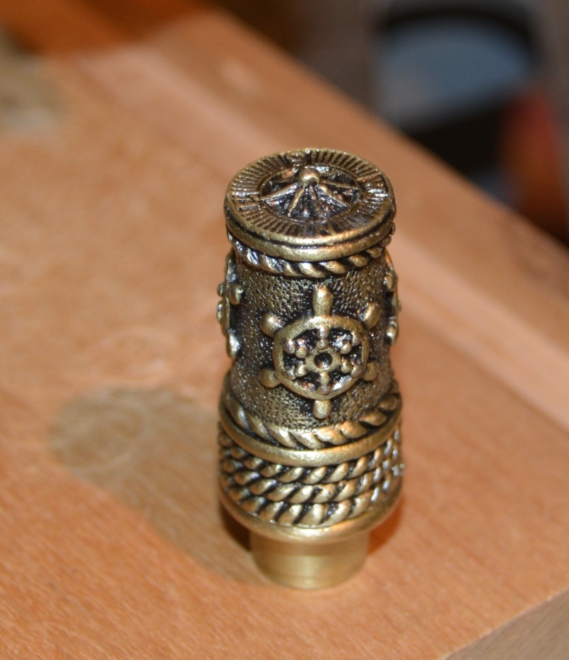

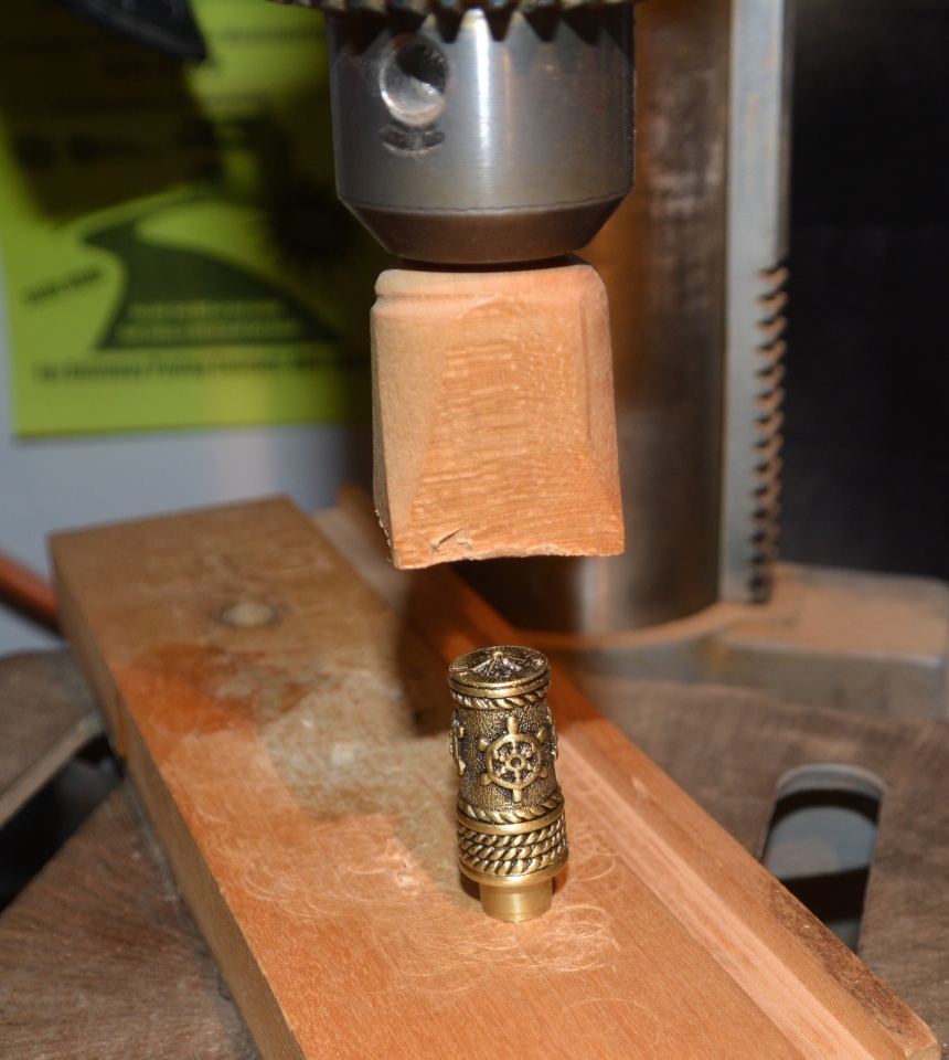

Recently I pressed fitted the top of a nautical pen on to the completed barrel. The wood pressed into the raised compass on the top and pressed it down flat (metal must be soft). Is there a way to press the raised metal compass without damaging it? Thanks Darrell

Pictures of nautical top. Darrell

Why am I not seeing the issue in these pictures?
I've made a few of these and never have I had one collapse upon assembly.
Either your pictures dont do justice to the damage or I'm just not seeing it.
If the top is collapsed, I would think you could make a simple jig with a drill point deep enough to be able to use a flat end of a transfer punch and with light taps of a smallish hammer from the underside with the top of the cap nestled in the jig and be able to reverse the damage.

Well, I don't think it looks bad that way. I suppose one could go at it gingerly with a hammer and punch and see if the metal will move.

Thank you for your replies. That is a new top. What was crushed was the small point on top of the compass....not major damage but enough for me to notice. I will try a collar around the top and press it in with the sides of the top bearing the weight. Thanks Darrell

I got a pen blank turned and finished for a nautical kit so I will turn a wooden collar that will avoid putting any pressure on the small point or even the compass rose. I'll make the ID so that it bears on the outside rim of the cap. Thanks for posting this. It will save me from marring the pen kit.

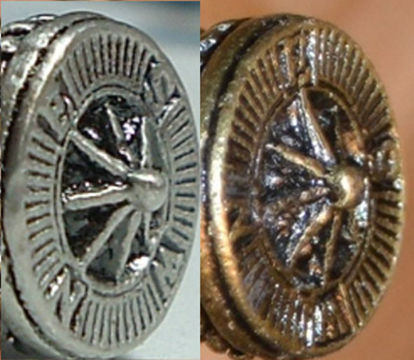

I actually think it was probably not crushed and is just a case of a crappy casting. Here is mine and yours side by side.
What I see is a continuation of the ball and ridges and no apparent sign of deformation, just a bad die cast and a poorly made mold.
Seems to me that if the ball top had been crushed into the rest of the casting it would immediately fall off.

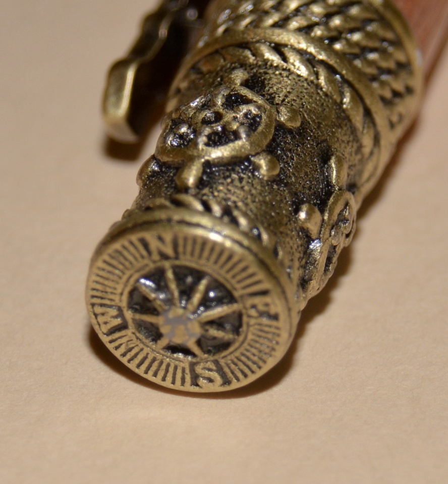

In the beginning I made two of the nautical pens and I felt both were crushed by me using a wooden block in my drill press. Her is a picture of the crushed cap. It does not have the raised pointed star like my cap in post #2 shows. Today I have made 4 more but will use a collar to press the cap into the barrel. Thanks Darrell

Ok, I can see the damage on this last picture. That is not the same cap as the first pics.
That looks like a defective molding. I would contact PennStateInd and send them the pic in an email.
