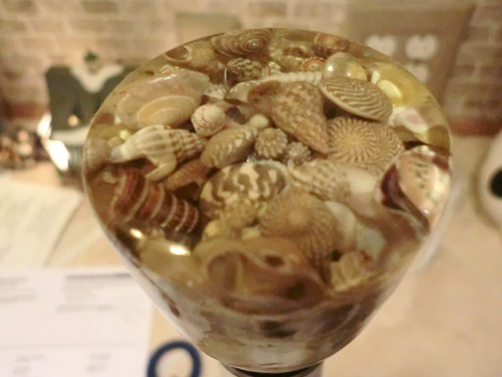

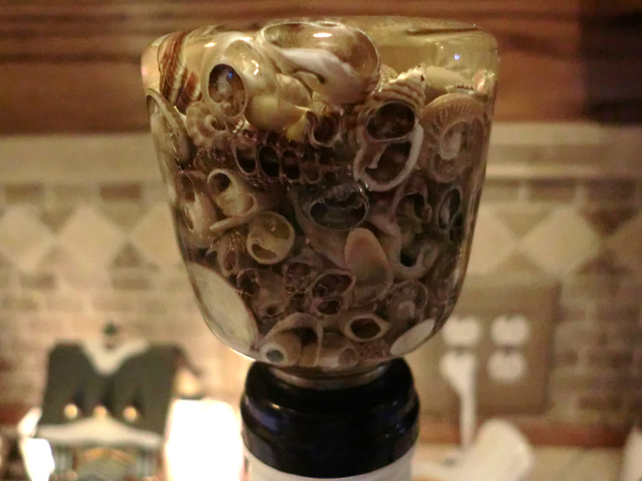

Seashells can be cast in in PR and turned with a carbide tool. Here is one of two bottle stoppers I made about a year ago. As I turned, I filled any voids in the shells with CA.
Don't know how well a pen blank would hold up being so thin.

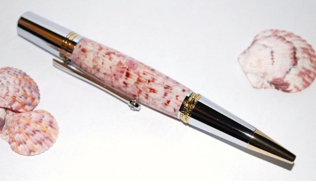

I did a set of pens with Black Clam shell chips. They were intended for decorating fingernails. I painted the tubes black then epoxied the chips (approx. 1mm size) to the tubes, cast in PR and turned them. The effect is stunning, the PR acts as a magnifying glass and brought out hidden colors in the sea shells. One or two "poked" out of the PR and made no difference, I touched them with a bit of CA and polished the pens as normal. Carbide tools recommended, I used a carbide tipped skew.
