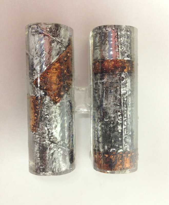

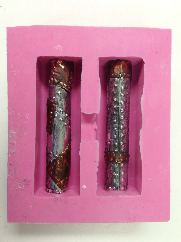

Let me first say thanks to Jjartwood and Yorkie who's designs I drew inspiration from. After seeing many of the steampunk designs from the talented members here and not being able to find blanks to purchase anywhere, I finally decided to try and make my own. The first two I decided to try were Sierra Vistas.

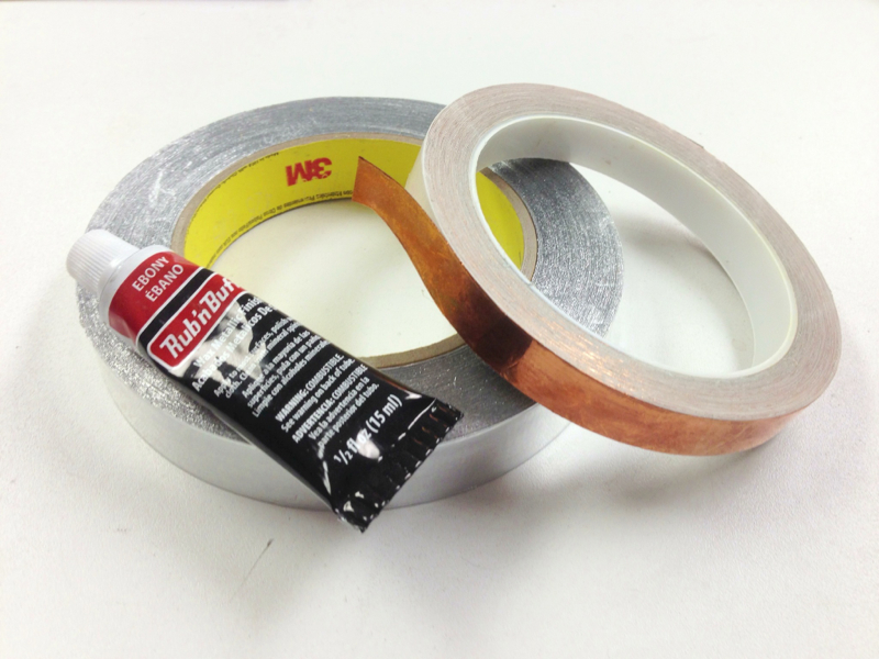

For the blank material I started with aluminum and copper tape as well as ebony Rub'n Buff for the distressing. I then created my imitated rivet pattern. Most I have see have the rivet dimpled inward. On mine i wanted it to look like the head of the rivet was sticking up so I did my impressions from the back side.

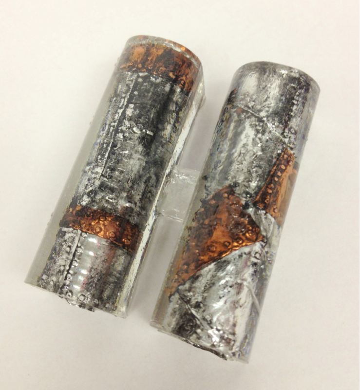

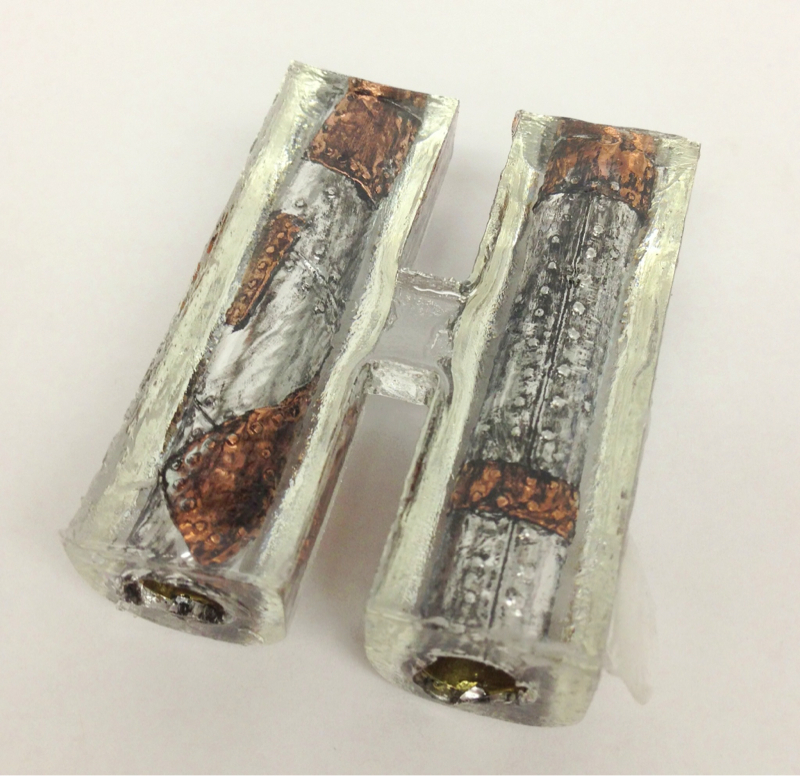

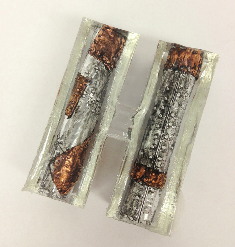

Here is a shot after I had the tubes patterned, wrapped and ready for casting.
And the cast blanks....... I used Silmar 41. I love that stuff!

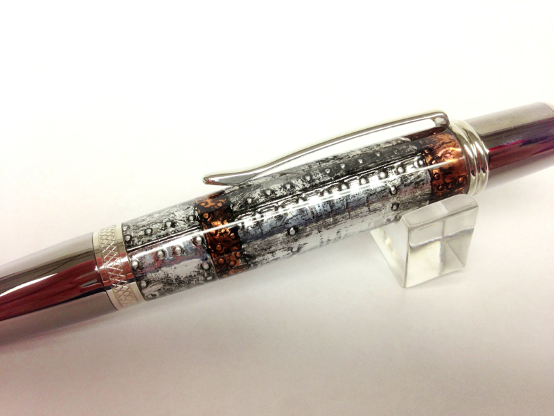

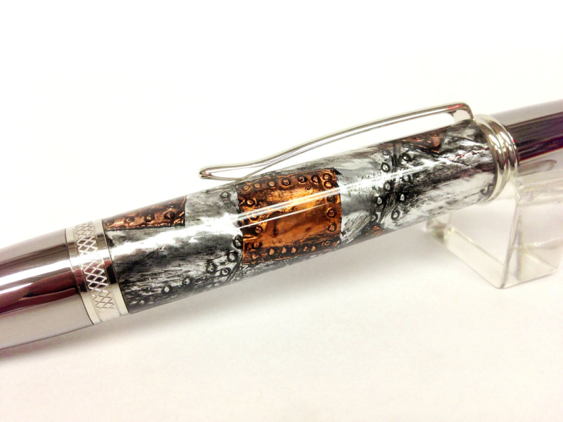

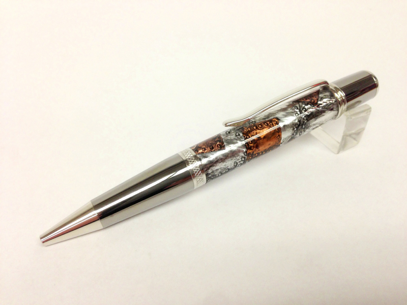

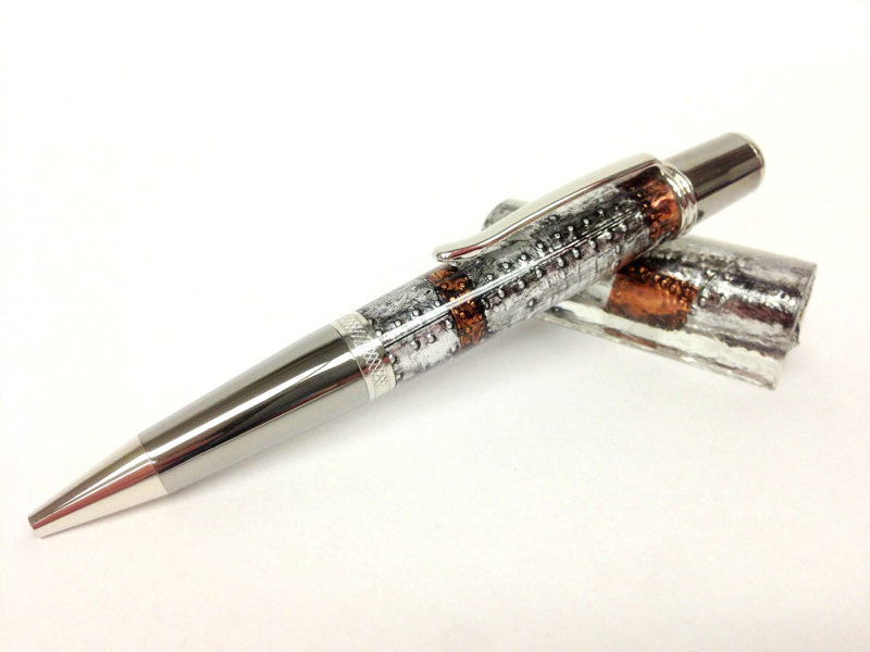

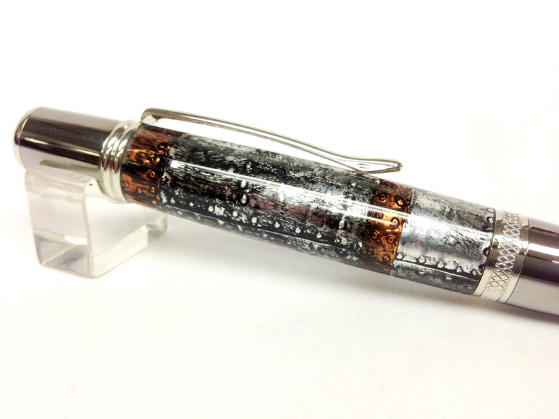

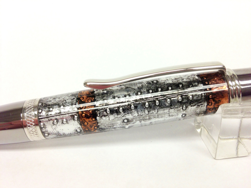

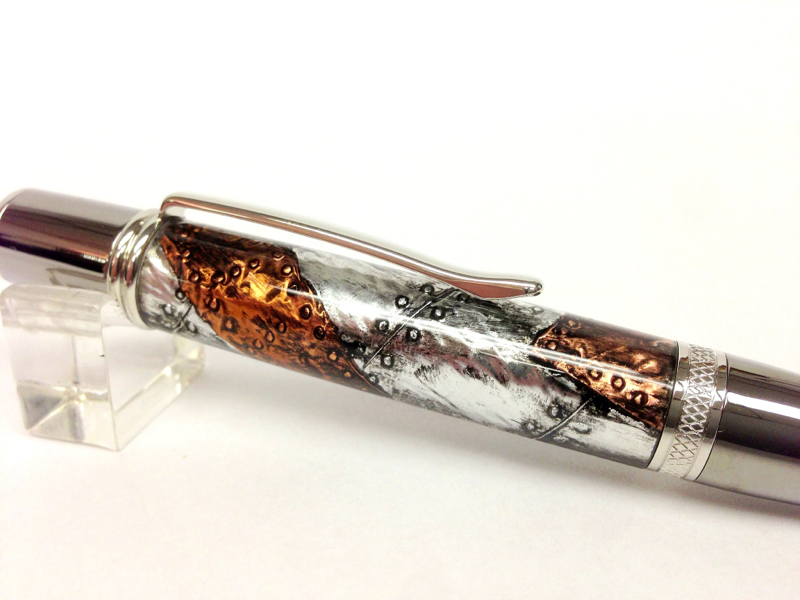

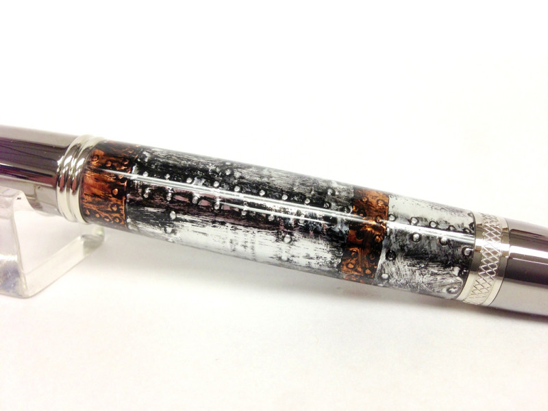

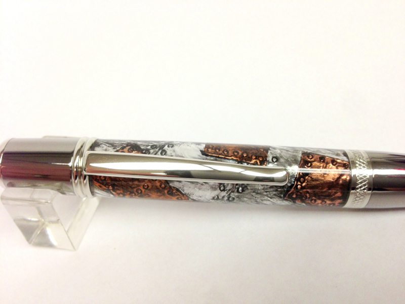

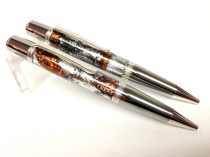

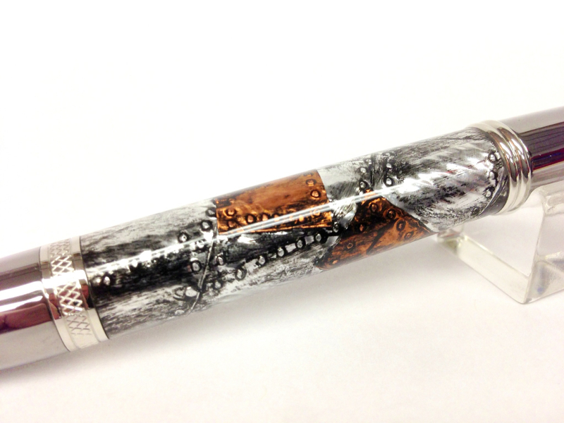

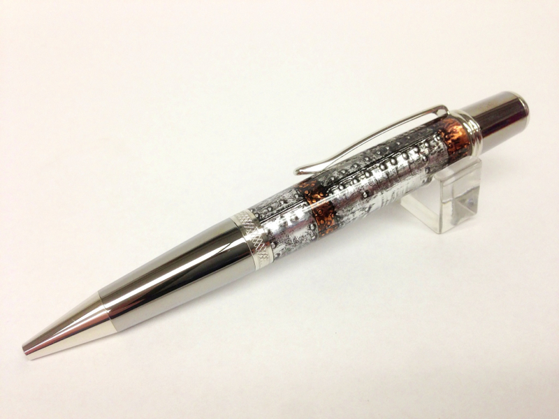

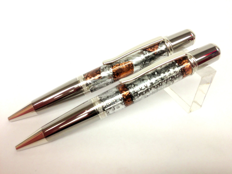

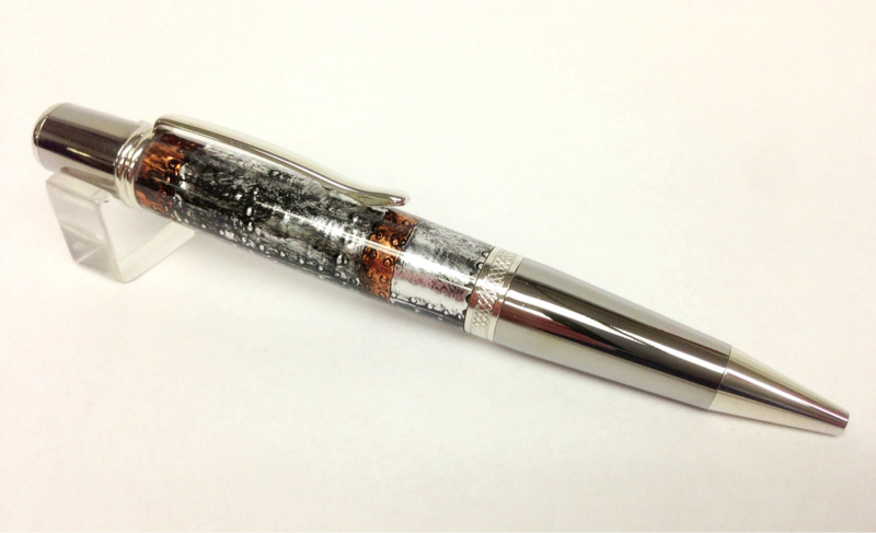

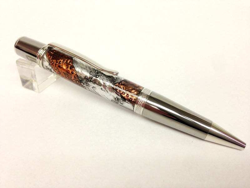

And here are the pics of the first blank I turned. I decided on Black Titanium/PlatinumSierra Vista hardware. I love how it turned out other than I need to get pictures with my Nikon D7100. All of these pictures were taken on my iPhone 5.
I would appreciate any comments and critiques.

Very cool, I really like the one with the copper set at an angle. I've been wanting to try this, may do it this weekend. I assume you can get both aluminum and copper tape as well as the rub N buff at a craft store like Michael's? Thanks for sharing.

I will be turning the other blank this afternoon as well as creating some more blanks. The Rub'n buff paint came from Hobby Lobby, but Michaels sells it as well. The tapes I ordered through Uline. I get quite a bit of office supply stuff from them and surprisingly enough they had it. You should be able to get the aluminum tape at Home Depot or Lowes in the heating/cooling duct work section. The copper should be available somewhere..... I'm just not sure right off hand! Give it a try! the results are worth it! :)

How did you do the rivets? They are so uniform.
I used a couple of improvised tools. One a small round carbide knife sharpener and second, a nail that i ground the point to a more rounded shape then set into a wood block. I then turned the copper and aluminum face down and did the pattern from the back side. As far as how uniform they are, Thank you! I did them one at a time and just eyeballed it. No measuring. :)

You can also get copper foil tape from stained glass suppliers in different widths. Just get the plain copper. No need for the silver or black backed foil.
