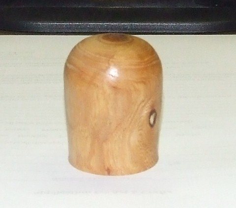

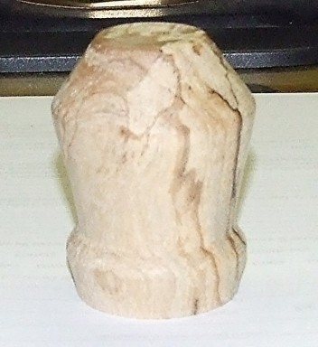

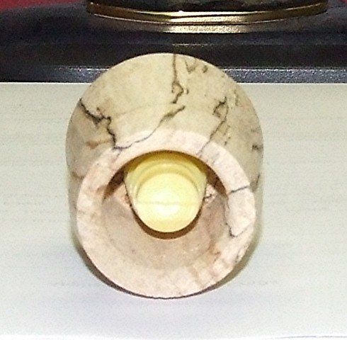

I tried a couple of the hidden corks this afternoon... I like them and may have to make them my signature bottle stoppers... I used the dowels and sleeves from Packardwoods. They come in packages of 10. The sleeves were yellow on this order and at first didn't think I liked the idea, but on the hidden corks, they work great.
The first is from a piece of Elm that was supposed to be the top of a peppermill, but I screwed up the body and I hate to waste wood.. the second is spalted maple. There's no finish on the maple and I need to harden a couple of soft spots.. the elm has one coat of poly and needs about 5 or 6 more to look good.

Chuck; Very nice. From what I can see these are the silicone sleeves rather than cork. What size is the bore?

Chuck, are these the upgrade corks that the wineries prefer, or the silicone ones with the stepdown dowels. They look great, and you just added # 1,212 to my list of things to make. :D:D

These are the silicone sleeves that I mentioned in earlier post.. they are on a step-down dowel that comes with the sleeves, these particular ones are from Packarwoods, but you can get them from CSUSA or Psi. The bore is pretty much same as Tony's notes.. 1 1/4" to fit over the bottle neck, about 1" deep, then a 3/8" hole for the step down dowel... really easy to do.
