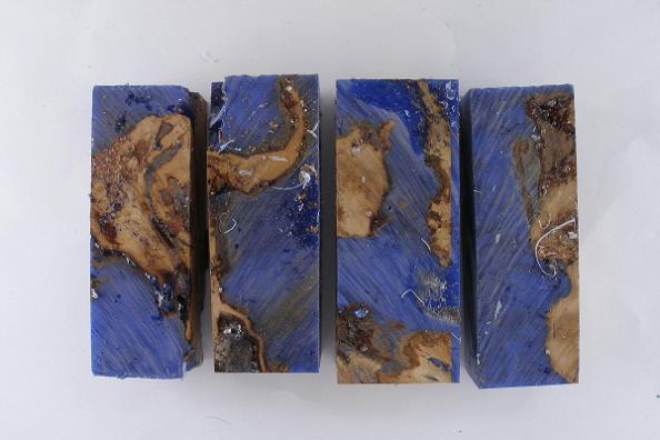

Sorry Karl, I just couldn't resist trying to copy this one. I just loved that Jr. Gent Michael turned with your blank. I may not have the green in mine that yours has though. We'll see how it goes. I plan on turning it later today or this week some eve. I also plan to Double Cast it. First I have to figure out what type of pen I want to make with the first one.
I have a new friend coming by Monday, I may give him the second set of blanks. I'll post a topic after the visit. He is a fellow pen crafter from this site.
The reason there is four small blanks is because I still use the small square "Castin-Craft" molds. So it ends up casting two blanks side by side instead of one long blank. Some day I'll be able to afford some of the rubber ones. But these work fine for now.

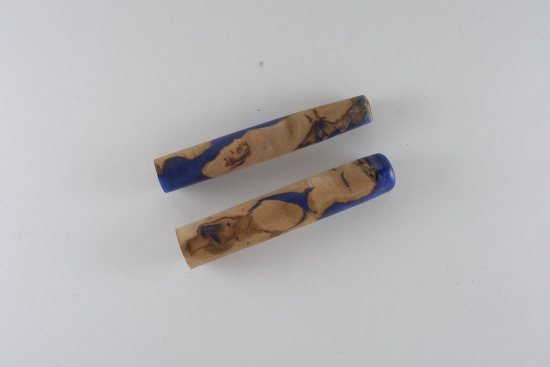

I turned two of them down to a couple thou under. They are now in the pot curing. Had to get creative to cast the closed end section. Corked off the opened end and stood it up in a piece of PVC. Glued everything real well so it wont leak or fall over. Seems to be working so far. I'll know for sure in the morning. Here is a photo of the tuned blanks before they went in the pot,,,,,,,,,

PR. I have a lot better luck with the double cast method. It creates a virtually perfect finish. I cant get the same with CA. But that's just me. I use CA/BLO on most woods. I learned how to use the BLO part of the equation a few weeks ago and love it.

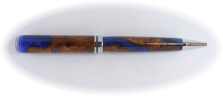

Here is the finished product. I also posted it in Show Off. It's titled "Double cast earth euro".
Thanks for looking and fallowing this little saga.

I've done 3 or 4 and I am getting to near perfection on the finish end of the equation. There are a couple of little quirks that have to be allowed for.
I took this from another post because I did not want to take that post off track.
Steve,
Would you elaborate on the quirks?
stevers
Dec 18, 2005
2,991
Bullhead City, Az., USA.
Steve,
The main thing I've found I have to watch is the thinner ends of the barrels on the second cast and at the time of assembly. Twice now I have had blanks crack right at the nib when I went to press in the nib. It is a two fold problem. First being, when I cast then re-cast the blank, junk gets into the inside of the tube. If I don't remember to clean it out with the pen mill and/or rat tail file, when I press in the nib, because of the thin material, It cracks out. (yes, that was a long sentence) I "believe" this is because of the thin nature of the nib end. It was on a Euro and a Jr. Gent II. This isn't so much of a finish problem as an after finish problem. I am also trying to get the PR of consistent thickness over the length of the barrels.
I have also had a problem on one cast with the PR adhering to the barrel cast first. For some reason it lifted off and left voids between the new and old castings. I'm still puzzled about that one. The only thing I did diff was using PVC to cast the second layer. And the other half of the pen was re-cast in a medicine bottle. Only thing I can figure is the PR reacted diff with the PVC. It may have shrank in an unusuall manor.
Anyway, I miss spoke, none of these problems are directly related to finish. The finish is straight forward, wet sand through 12,000 MM and polish with Hutt PP.
