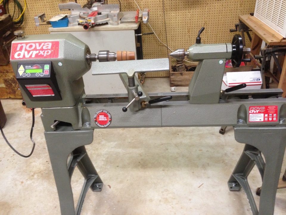

I stopped off at my local Woodcraft a couple of weeks ago and saw that they still had 3 of these Nova DVR XP lathes leftover from their Black Friday sale. I went home & told my wife about the $800 discount & $300 worth of free tools and without hesitation, she said "sounds like you better jump on that deal".
I am so blessed to have a wife who not only tolerates this obsession, but also enthusiastically supports it.
My son & I got the lathe set up, cleaned & adjusted yesterday. I still need to install a surge protector (this thing has a microprocessor for load sensing & speed control) and extend my DC ducts before I do any serious turning, but boy is it smooth & quiet.

I see a Jacobs chuck in the headstock with some wood. Can't tell from the pic but I hope you have a draw bar to keep the chuck in place. We don't want to hear about any injuries.

Yep! There is definitely a drawbar on that chuck!

One accessory I find invaluable -- the Acruline double-ended Morse taper. It makes realignment of the head & tailstock really simple, whether it's after you rotated the headstock or simply want to make sure the tailstock alignment plate hasn't drifted.

Thanks for that link, Duncan - I am going to order one tonight! I did my initial alignments with my 60 deg centers, but that alignment tool should make it a lot easier & more accurate.

I still use 60 degree centers as a quick check to see if things are still aligned: just trap a Stanley cutter blade between the points, if the blade stays square everything is good.
The way I do it ... take the centers out, loosen the 4 hex bolts on the plate under the tailstock, and loosen the bolt that locks down the headstock. Put the Acruline into the tailstock and slide it all the way into the headstock. Tighten all the bolts, et voila :biggrin:

Congrats on the new lathe! It looks too clean. Be sure to post an "after" photo. :)
Thanks - I will.
I finished that bottle stopper that's in the photo & made a plywood shelf for the bottom of the stand today. I need to extend my DC ducts over to the lathe before I do any serious turning though & I'm going to install a couple more light fixtures. I can really tell that I'm going to enjoy it - hard to believe how smooth & quiet it is.
