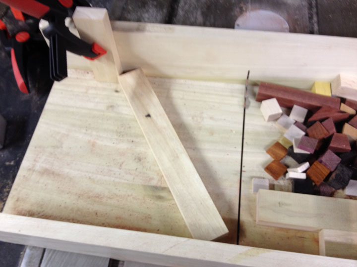

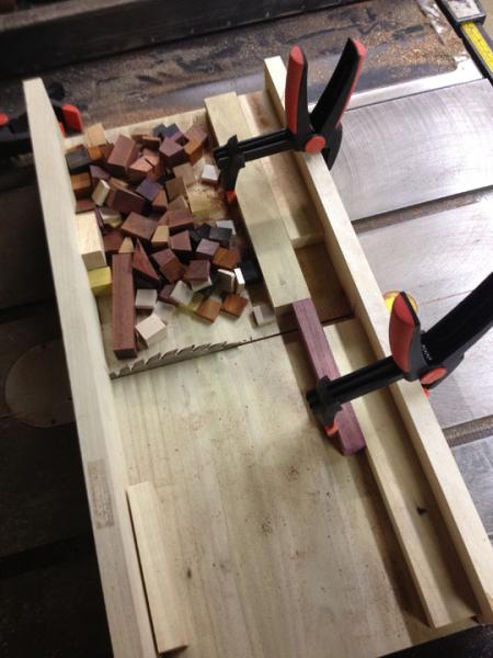

Just finished my first jig last night. For cutting blanks and segments on a table saw. Note that in this photo I have the segments spread out on the jig. That was just for the photo.
Bought a Forrest WW II, Thin kerf 48tooth with stabilizer and a zero clearance insert.
Jig was put together based on this plan:
Pen Blank Table Saw Sled Jig - by LarryDNJR @ LumberJocks.com ~ woodworking community
If anyone has some links to ideas for building these next 3 jigs, it would be much appreciated!!! I think I want to do them all on a table saw.
1.Jig for cutting repeatable angles. You can see how I'm doing it in photo 2, but it is far from ideal in a few ways. Not secure and can slip out of alignment. Not easy to set up and hold the angle.
2.Jig for cutting blanks down the center.
3.Jig for cutting blanks in half from one corner to the opposite corner at the bottom.
4.Jig for cutting wood on it's edge, oriented as a diamond.
Other question for this jig:
1.On this setup, I am getting kickbacks around every 5-10 cuts. Having the backstop really helps, but I can see how a stray might hit the backstop and ricochet towards me. None are shooting in my direction right now. Some also hit the backstop hard enough to break. On the piece opposite the blank, what about putting a small feather board there? Any other ideas?

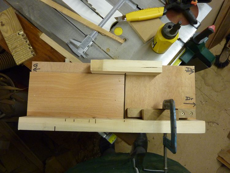

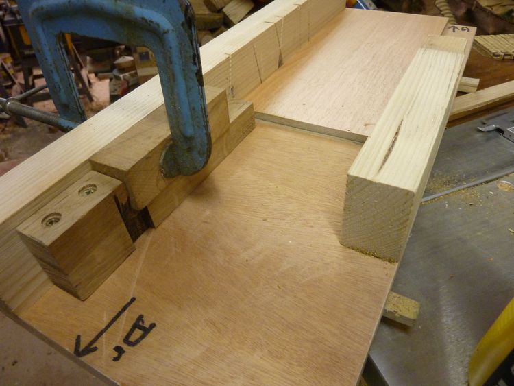

That is the jig i use to make repetitive cuts without kickbacks.
I built it from Steve LATTA'S Jig, i see in his DVD.
On the 2nd pic On the right, the stop slides under the locking length.
In this way, when the saw begins to attack the wood, I remove the stopper to the right and stop the cut piece does not remain prisionnier between the stop and the saw blade.
This avoids damaging the parts.
on the left, I put a thin board that makes the wood is raised.
After being cut, it is switched to the right and away from the saw blade.

Might want to cushion the backstop with foam/fabric. Also another idea is build a clear plexiglass cover to keep any from flying out.

Looking at your second jig it would seem that you should have the wood, which determines the angle you are cutting, supporting the wood instead of you trying to hold the wood being cut against the fixed support. This would support the wood and keep you from trying to stop pieces from coming back at you. The way it is now its looking for an accident to happen.

Moishe, you need a solid stop behind the cutoff piece as a continuation of the piece behind the blank and you cannot have the end butted up against a stop as you do because it will give you kickbacks. If you had a 1/8" thick strip that you could put between your fixed stop and the blank you are cutting, then hold the blank firmly against the back rail and remove the 1/8" strip before making the cut, the cut piece will not kick back.
Having a full width back guide piece to your cut-off sled may allow the blade to go through the back of the sled. Normally the back guide will be taller than the blade depth of cut and additional wood added to the back of the sled to prevent the blade from contacting your hand. A stop can also be added to the table saw bed in front of the sled to prevent the blade from going further through the sled than is desired. With your blank guide piece spaced forward of the rear of the sled a stop could prevent the blade from going through the back rail of the sled.

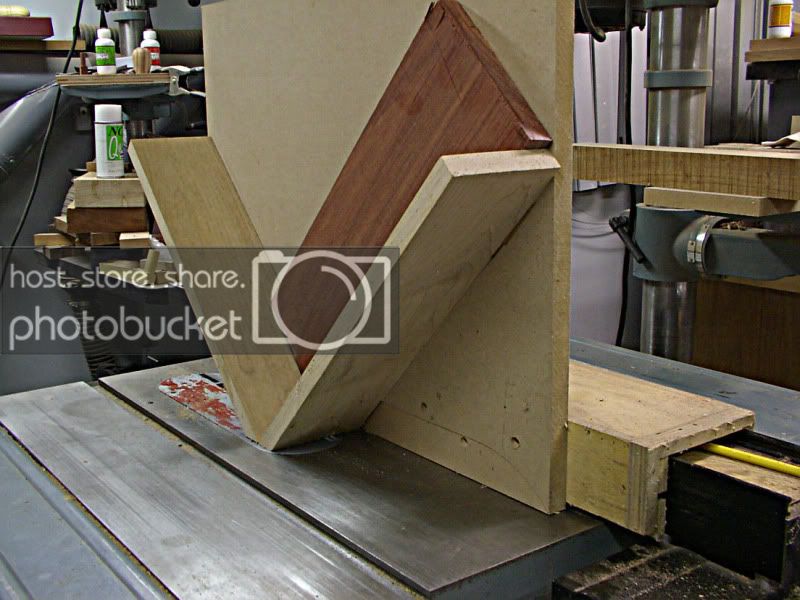

Cutting a diamond will also require a special jig and proper holding methods.

You will find you will be making jigs for the rest of your woodworking career. They are an invaluable help in the shop. Yes there are aftermarket devices that work well. I have a Dubby cutoff sled that is invaluable to me and use it all the time. There are many homemade versions. One thing I do when using this sled and I am cutting small pieces I use a trick that Malcolm Tibbetts uses when he makes his segments for all his segmented work. When he uses a tablesaw and uses a sled he has an angled piece of material on the outside of the blade. What this does is, as you push the piece past the blade it falls onto the angled piece and falls away from the blade so it never gets caught up in the backside of the blade. The backside of a blade is what gives you the kickback and slings those small pieces toward you. I do the same except that I make mine the length of the blade and double stick it to the table right next to the blade. It has to be a shade lower than the sled material. Works great.
